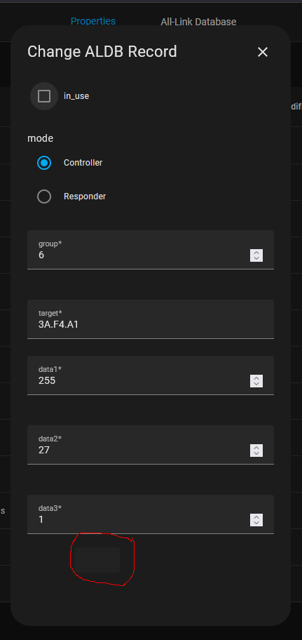

Hi All, I migrated from Homeseer to Home Assistant and brought my Insteon setup over with me. One of the buttons on one of my keypads was setup to turn all of the lights on and then off in a certain room. This included a lamp module that is now used for a different purpose. So I want to delete the controller link from the keypad button. I go into the Insteon integration, then settings, then click on the keypad device, then “All link database”. I see the link I want to delete and click on it. Then try to uncheck “in_use” but I’m not seeing a way to save this. When I uncheck it, nothing happens (no “save” option comes up) and my only choice is to click the “x” in the top right and that doesn’t save my change. The box is still checked the next time I open the link. I think I need to somehow get it to save that pending change then “write to device” but can’t get it to save the pending change and “write to device” is grayed out.
Any tips on what I’m doing wrong? Thx in advance!

Thanks all for the responses. I did some surfing around to try to figure out what’s going on. I came across someone on the Github site that posted an issue related to updating insteon scenes that mentioned “hover the mouse…to find the invisible Okay button…”. Invisible Okay button???
So sure enough I went back into the All-Link Database, unchecked “in-use” and hovered my cursor around in the window and found two rectangular outlines near the bottom that showed up when you hovered over them, but were not visible otherwise and contained no text regardless of if you were hovering over them or not.
The one on the right (I have shown in my screenshot above) appears to be the “Okay” or “Save” one (I presume the one on the left is a “Cancel”??) because once I clicked on it, it kicked me out to the “Properties” tab (which incidentally is the issue that the person was highlighting in the Github post) then I had to click over to the All-Links Database tab again and sure enough, “write to device” was now an option. I clicked it and when the links came down again after the write, the link I wanted was no longer shown. Turning on “Show unused” showed the link there with “in use” as “no”.
Looking at some other issues in Github it seems others have noted these invisible buttons or inability to “save” or “okay” a change. It seems that maybe this integration is not being maintained anymore as the last closed issue looks to be from March 2023.
On a sad note, even though I was able to accomplish unchecking “is used” this doesn’t appear to have actually worked to “remove” the link because hitting the button on the keypad still operated the lamp module. But at least I got to the bottom of the inabilty to “save” changes in the integration. So hopefully someone will come across this post and can look for the invisible save button.
