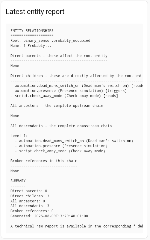

Would this be any help?
You get a report like this:
Thanks - that’s the way.
This looks interesting, but for now just searching in the automations.yaml file is good enough for me.
Thanks for the suggestion though.
