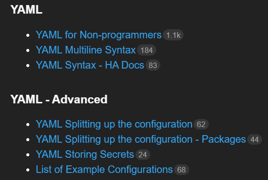

Look in the Cookbook at YAML-Advanced.
I have been using a mixture of Legacy format and New Format for quite some time. @jyavenard it sounds like you are already setup with ‘packages’
