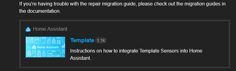

I’m frustrated because I can see you did not click on the link, that tells me you haven’t used the guides in the official documentation on home-assistant.io.
Here’s the link again.
Please try to use those guides before asking questions. And if you have problems, mention which guide you’re using (there is 3 of them) and what you’re confused about.
