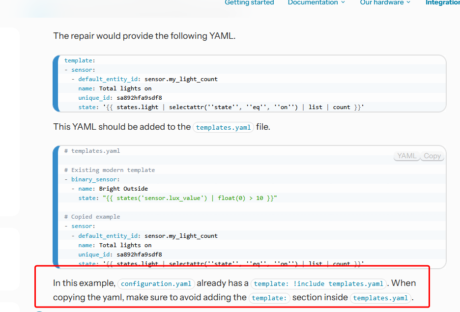

Hi, have you looked at the link I posted here?
It has a step by step process that tells you exactly what to do. To me, it seems you haven’t read it. Step 2 covers where the new templates should go.

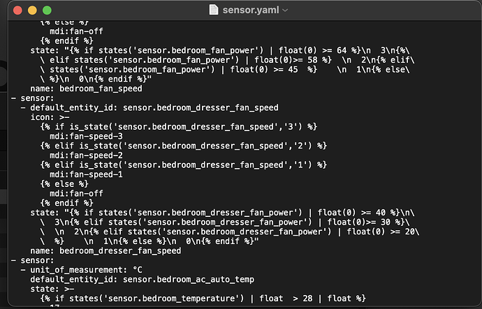

I truly appreciate the tool being available as it helps a great deal. However, the generated state definitions have a lot of escape sequences which need to be replaced with the original code for better readability and maintainability. After that, everything needs to be manually copied / pasted to their respective files.
So all in all and unfortunately for me, all required work demands more time than I have or can afford now or in the intermediate future.
The tool formats it without the escape sequences. The repair does not. Are you sure you used the tool?
It feels like you spent more time thinking through and writing out your response than downloading the integration and trying it out. It took me all of 15 mins to update mine including the removal of the tool. It’s really very good.
Yep. The output YAML files contained escape aequences for me unfortunately.

Here’s one corresponding to the screenshot:
bedroom_dresser_fan_speed:
  value_template: >
    {% if states('sensor.bedroom_dresser_fan_power') | float(0) >= 40 %}
      3
    {% elif states('sensor.bedroom_dresser_fan_power') | float(0)>= 30 %}
      2
    {% elif states('sensor.bedroom_dresser_fan_power') | float(0) >= 20  %}
      1
    {% else %}
      0
    {% endif %}
  icon_template: >
    {% if is_state('sensor.bedroom_dresser_fan_speed','3') %}
      mdi:fan-speed-3
    {% elif is_state('sensor.bedroom_dresser_fan_speed','2') %}
      mdi:fan-speed-2
    {% elif is_state('sensor.bedroom_dresser_fan_speed','1') %}
      mdi:fan-speed-1
    {% else %}
      mdi:fan-off
    {% endif %}
Why are they in sensor.yaml? The custom integration converter tool wouldn’t have done that.
Don’t ask me. I didn’t make the tool.
