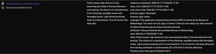

I am having trouble with the following template. It used to work by splitting the attribute for BOM weather at a 230 character limit. I then recombine the states as shown below. This is to overcome the 255 character limit for sensors.

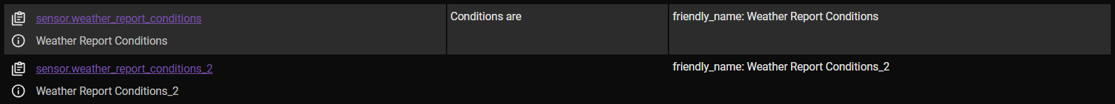

Now it is only outputting Conditions are none of the rest of the state (weather report attribute) is shown if it exceeds 255 characters.

This is the current state of the two sensors that should contain the information of the attribute below

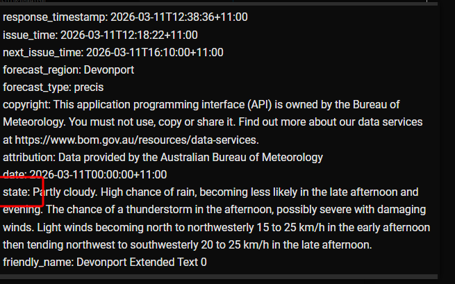

This is the attribute that is meant to be split into the two sensors.

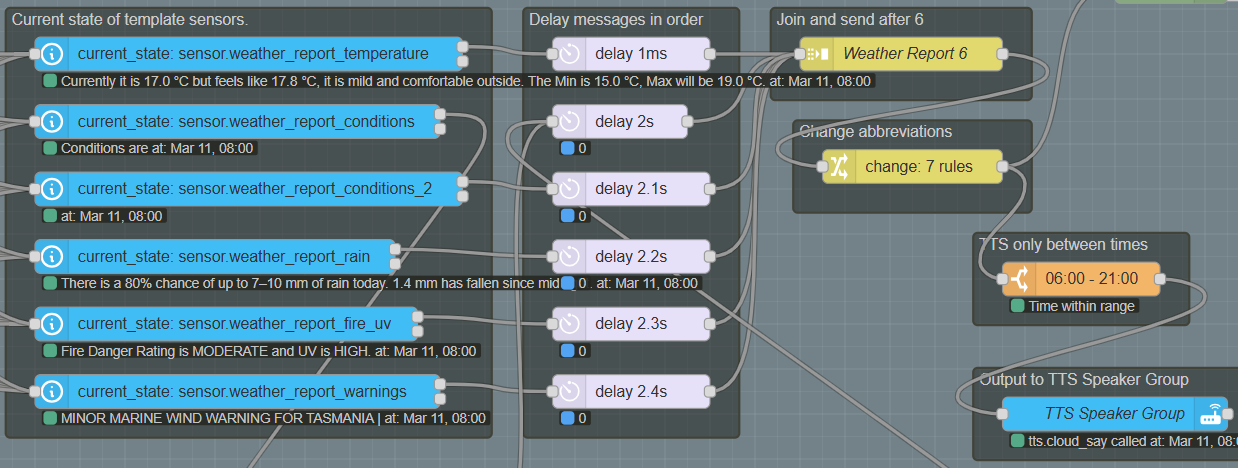

Where I recombine the state of the sensors to form a full weather report in NodeRed

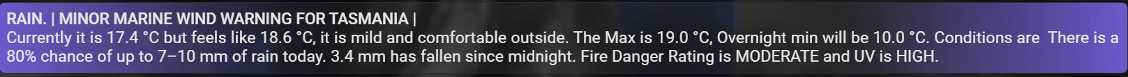

Where I recombine the sensors to create a weather report using mushroom template card.
                  type: custom:mushroom-legacy-template-card
                  primary: >-
                    {{ states('sensor.devonport_short_text_0') | upper }} | {{
                    states('sensor.weather_report_warnings') }}
                  secondary: >-
                    {{ states('sensor.weather_report_temperature') }} {{
                    states('sensor.weather_report_conditions') }} {{
                    states('sensor.weather_report_conditions_2') }} {{
                    states('sensor.weather_report_rain') }} {{
                    states('sensor.weather_report_fire_uv') }}

I cannot say for sure that’s your issue, but using state_attr to get the state seems odd (even if it worked before for you). Perhaps try using the states function in your templates like you do in your card config.
It’s not odd, it’s just not correct in most situations. There is no way to get the state using state_attr. state_attr only gets attributes. However, his entity has a state attribute.
Meaning, his if statement is likely working properly.
{{ details[:230] if details | length < 230 else '' -}}
If the length is over 230 characters, the result will return nothing. That’s exactly what’s happening here.
He doesn’t need to have that if statement, he can just output {{ details[:230] }} and it will always output 230 characters or less.
The : in splicing means “Everything”. when you use [:230] this says "output everything before the 230th item. If you don’t have 230 items, then you will simply just get a list of all the items that you do have. With strings, items are characters.
If you use [230:] this means output everything after the 230th item. If you don’t have 230 items, you will get an emtpy list. In the case of a string, you will get an empty string.
Classical shadowing of names. This is what caught me here and thanks for pointing that out. If it was the regular state, I just meant I’ve never seen it done this way, because, like you say, it’s only for attributes.
