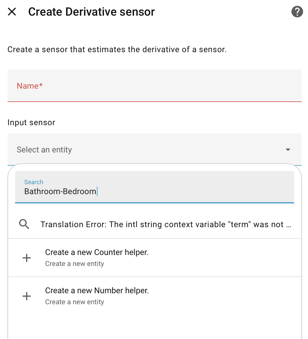

I have trouble getting a derivative from a templated number: it doesn’t show up as a selectable option.

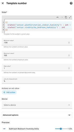

This is the number:
  states('sensor.weatherstation_indoor_humidity') | int -
  states('sensor.vindstyrka_bedroom_humidity') | int
And this is the selector - happens if the unit of the template number is “%”, or if it is left blank
What am I doing wrong?
You are using a template number when instead you should be using a template sensor.
A number is used when you want to control the value. A sensor just displays a value without any ability to control it.
