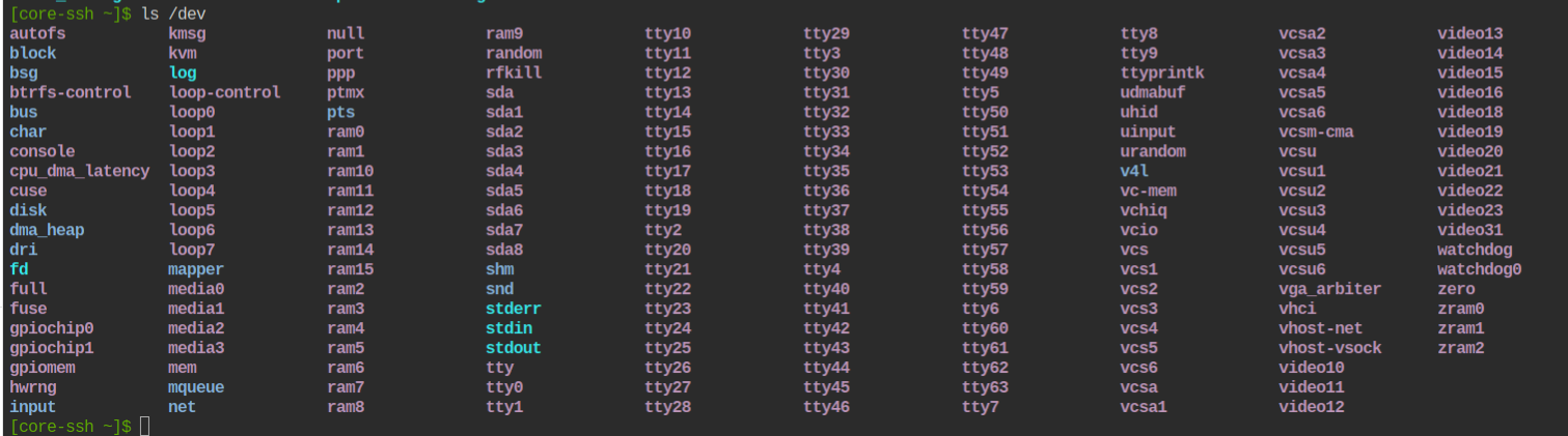

In the console, I don’t see anything like ttyUSB* when I list /dev:
I think this is finally working. I pulled the power TWICE after running the serial configurator (missed that initially) and ttyUSB0 became available. Configured the DeskPi Pro add-in for that and it now seems to be running.
