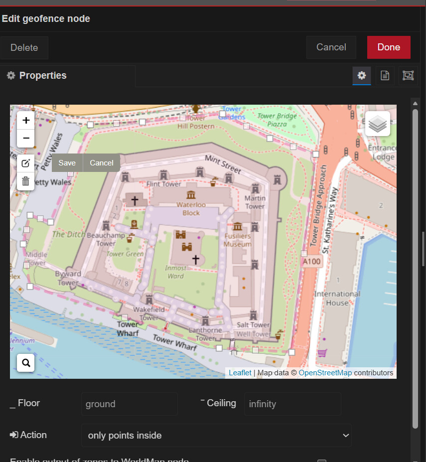

If you use Node red then you can draw a polygon around for instance the grass area of Tower of London.
This could then set a sensor or set a device tracker.
