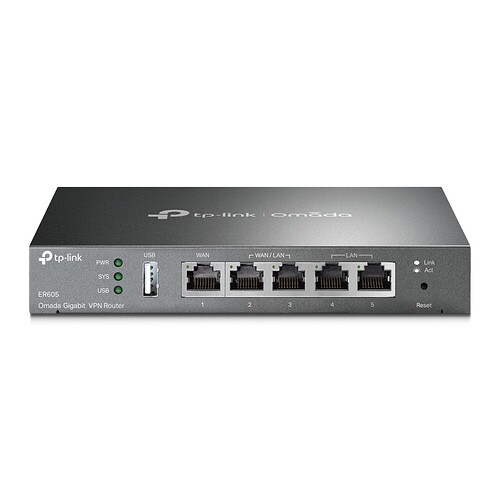

Its a TP-Link ER605 Router, with standard Firewall config I’ve not modified it , and its controlled via a omada controller.

Yeah, that’s not a standard router, it has a number of security functions (SPI, DoS protection…), in the firewall, as well as a VPN.
It just means that most HA users will never see alerts such as this.
I’ll keep digging. Already trying to trigger SNORT by passing a ICMP-TS request through it…
I’ve had this router for aages, however, you might be on to something, I think there may have been a recent firmware update, which might only now be alerting on this report, trying to find the release notes now
