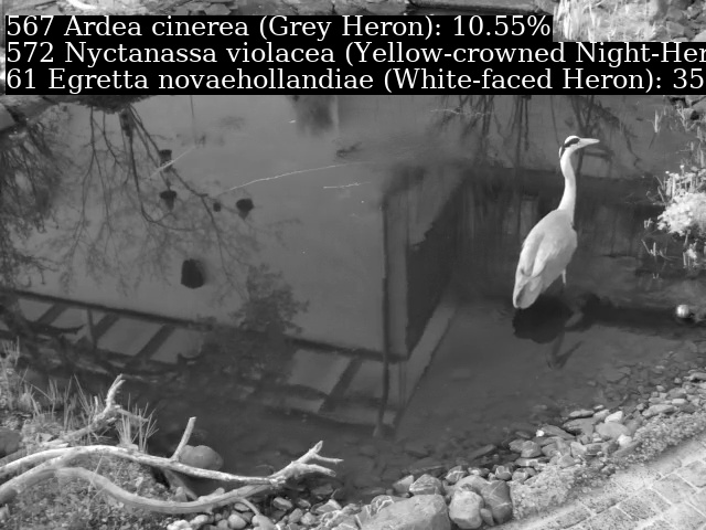

Check out my repo, maybe it’s the right one for your idea.
Can it be trained for other animals too? My pond is predated by Herons, Ducks, Cormorants. They all either eat all my fish or plants + disturb the soil so it’s murky…
Theoretically, yes. The Google model used recognizes over 900 bird species. However, using and configuring it isn’t easy and requires a lot of testing. For your massive bird infestation, I recommend a net over your pond.
