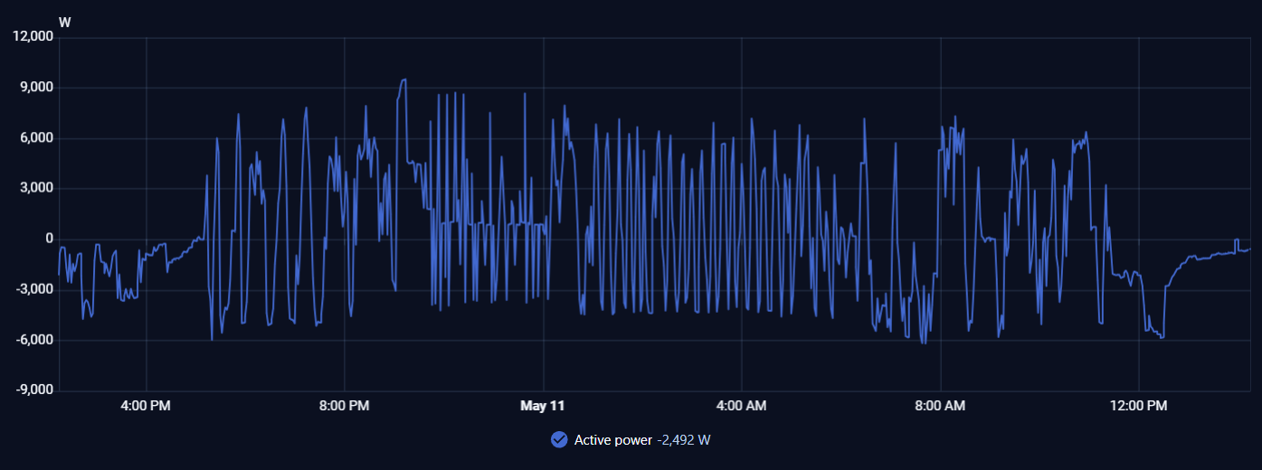

I've got a device which, due to a firmware bug, sometimes does this:
As you can probably imagine from the fact that the values are in watts, this not not healthy for said device, and I'd like to get an alert when it happens. I've figured out a way of doing it but I thought I'd ask for feedback on whether it's the way to do it. The idea was to use a Threshold helper to check when it goes outside bounds (upper = 5000, lower = 4000), and then connect it to a Statistics helper with max_age = 60 minutes and trigger an automation when count > 3 or 4, something like:

An update on this after a few days testing, the above doesn't actually work because it triggers continuously when the power usage is outside the given range, not just once when it crosses the threshold. Unfortunately there doesn't seem to be a sensor type that deals with this, requiring an automation for each range-exceeded event that increments a counter, which can then be examined by a statistics sensor:
