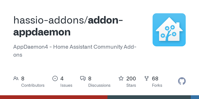

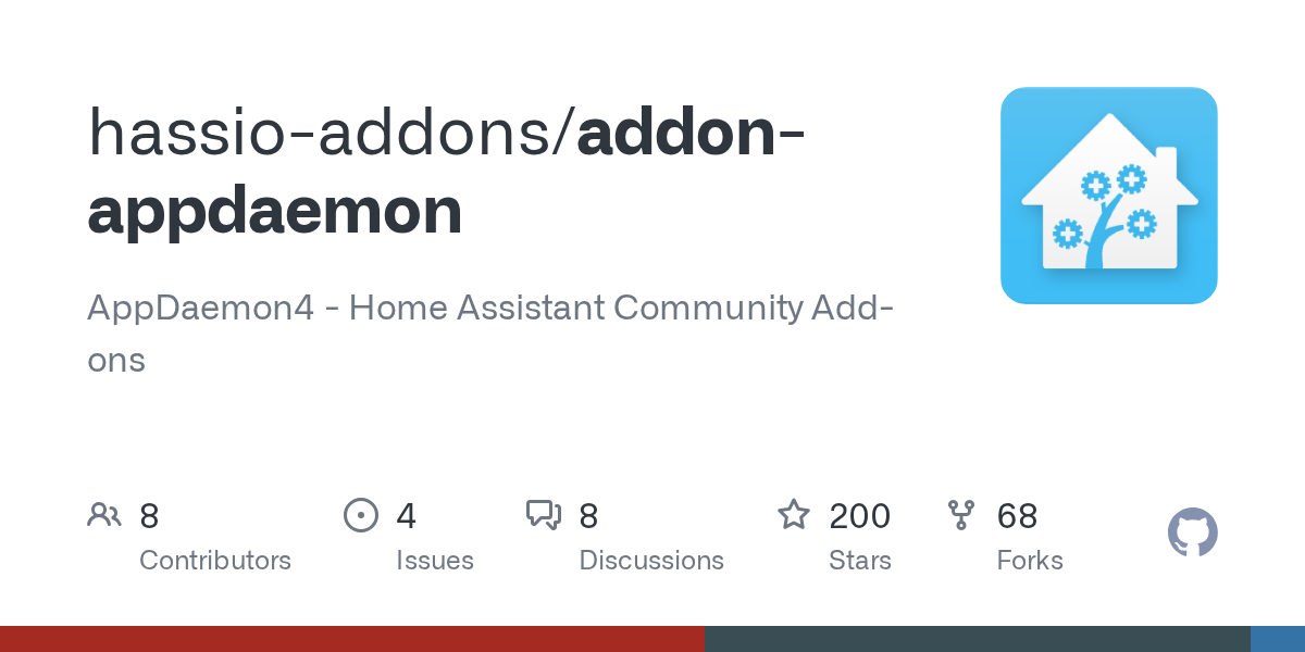

  • If you still want to automate stuff in Python look at the appdeamon addon. You don’t need to develop an integration for automating stuff.
