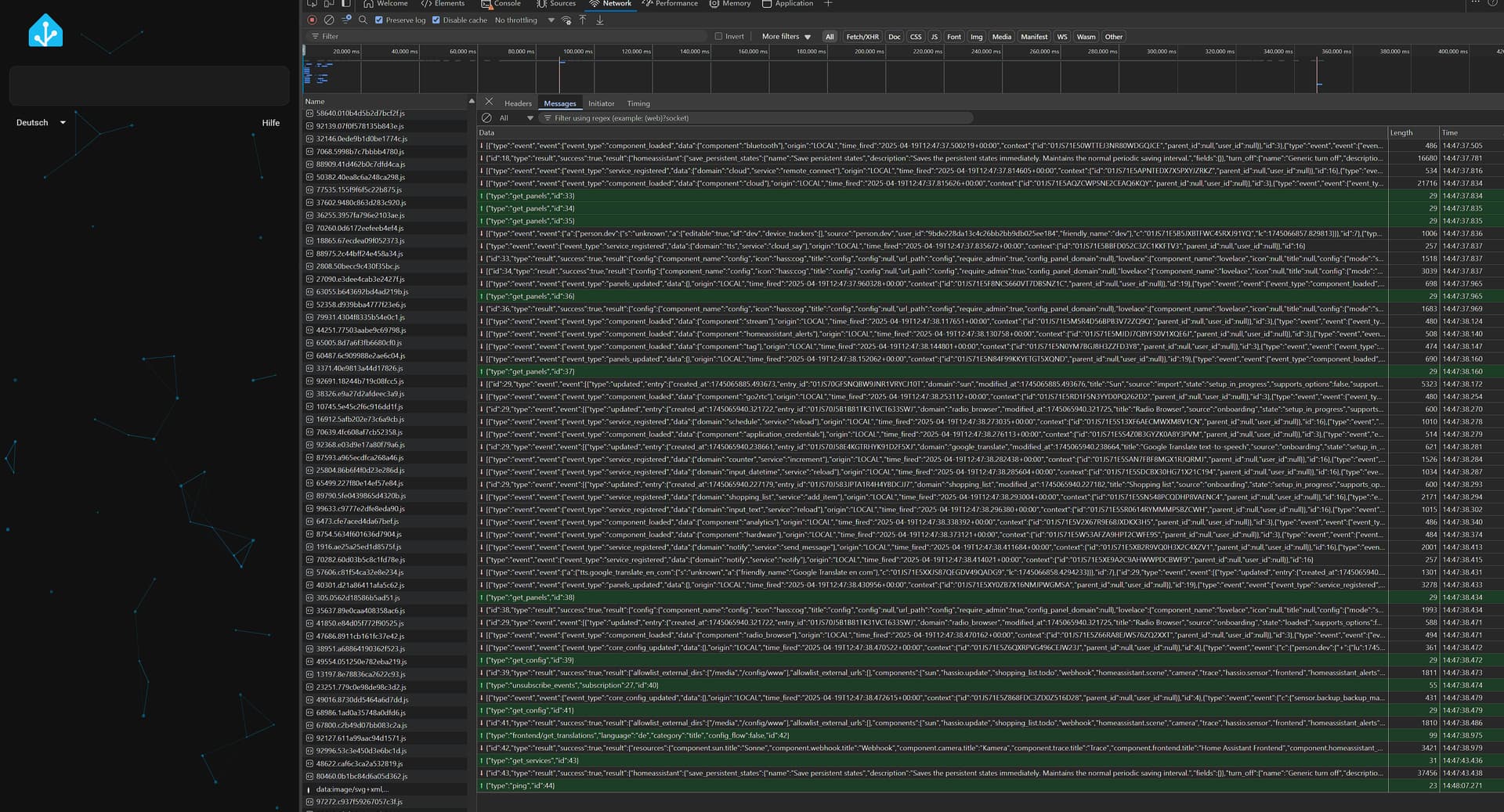

But now I’m stuck on the onboarding screen of homeassistant.
But it looks like the websocket connection is working and also no errors in the js console:
