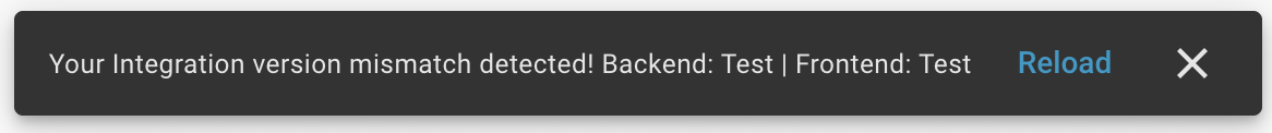

  showVersionMismatch() {
    // Show toast notification with reload action
    // Using hass-notification event instead of persistent_notification
    // because toast only appears in current session and gets immediate attention
    const message = `Your Integration version mismatch detected! Backend: ${this.backendVersion} | Frontend: ${CARD_VERSION}`;
    this.dispatchEvent(
      new CustomEvent('hass-notification', {
        detail: {
          message: message,
          duration: -1,  // Persistent until dismissed
          dismissable: true,
          action: {
            text: 'Reload',
            action: this.handleReload,
        bubbles: true,
        composed: true,
  // Arrow function to preserve 'this' context when used as action handler

Wow. Great generic implementation of version code. Nicely done. One suggestion on showVersionMismatch()
Here I suggest a Toast rather than Notification in sidebar as the later would be confusing as it is shown for all HA sessions, whereas a Toast is just shown for the current session and will get immediate attention.
Try something like…
this.dispatchEvent(new CustomEvent("hass-notification", { detail: { message: message, duration: -1, dismissable: true, action: { text: "Reload", action: this.handleReload } }, bubbles: true, composed: true }));
yes better :+1:
I’ve updated the snippets.
