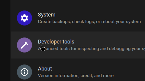

If you are missing the Developer tools menu item in the left menu after 2026.2 HA update, You can have it back right now.
In the latest release party, the team indicated they were working on development for the left menu, but if you are looking to get your Developer Tools menu back in the mean time, here’s a way.

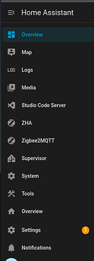

Custom Panel will allow you to add this or other things to your left panel menu.
Remember a few years ago when Supervisor and Logs were also in the left menu. Well, on mine it is still there. Want ZHA in the left menu, I got you.
Here is my panel-custom yaml as it stands at the time of me writing this (below).

To get the exact link to use on your system, click this then grab that URL for the Custom Panel once you get there.
Open your Home Assistant instance and show your state developer tools.
Replace my
with the path you will see in your URL bar in the header of your browser.

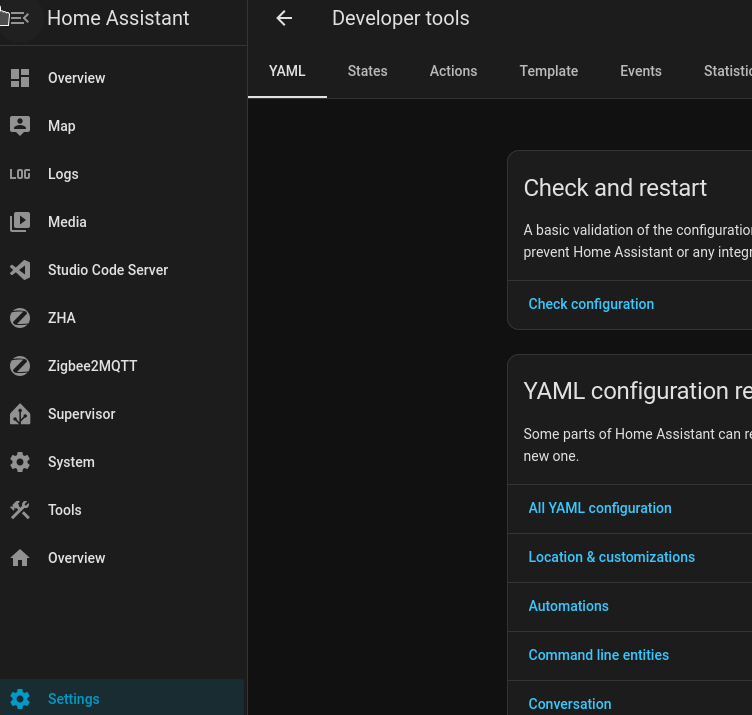

Hello…
I have tried this:
- name: config/developer-tools
    sidebar_title: Tools
    sidebar_icon: mdi:hammer-wrench
    module_url: 'https://10.10.100.8:8123/developer-tools'
    embed_iframe: true
    require_admin: true
    config:
      ingress: Tools

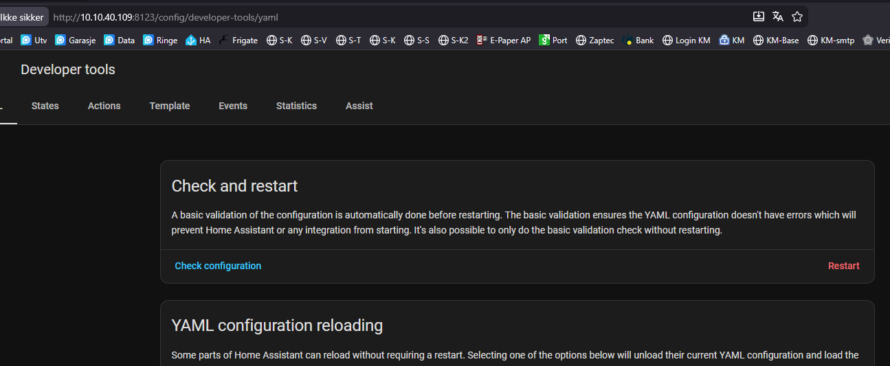

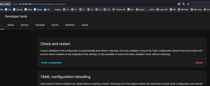

But this one opens The restart\Yaml menu… Se picture. It is not opening the actual developer Tools
Any ideas what is doing this?? Earlyer i have a simmilar one, thats was my check yaml\restart ha etc…
Did you change your IP address. Mine is fine.
I think you missing the config in the url.
My suggestion to go to Settings and right click on the menu, and copy link and then paste the link into your yaml file.
That is the way to do it…
Click this then grab that URL for the Custom Panel once you get there.
I fixed the top post to reflect this. Thanks, @patrikg
I also made it a WIKI so that others can tweak where needed.
NO, It Opens The Developer-Tools, as it say, and first #Tab is Yaml, Hint the URL in your browser
If you click another Tab, and go out of Developer-tools, i.e Another dashboard, and back again you should then come to the latest Tab, you accessed in Dev-Tools

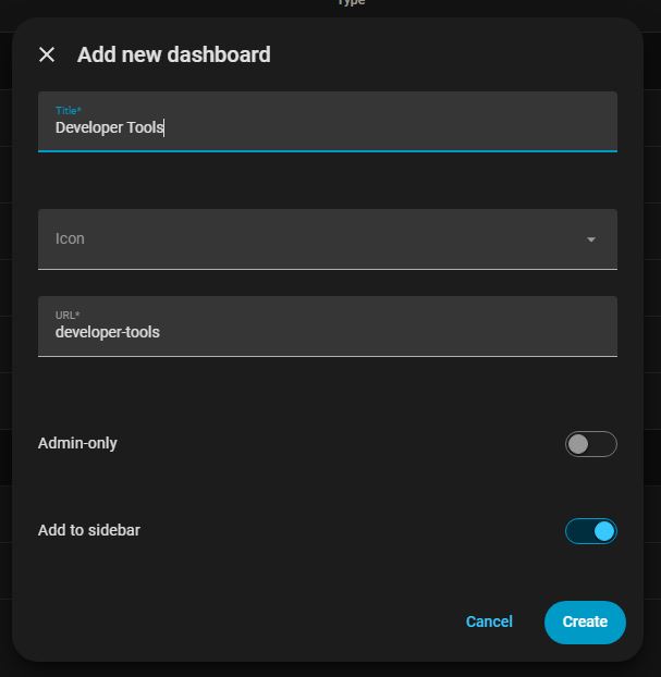

I had to Add this back to a to My Test Instance Yesterday,
but did it as I had previously with no Yaml required.
I Did it Via:-
Setting - Dashboards - Add dashboard,
Created a new dashboard from scratch,
Filled in the Fields & It was Done.
Typing "Developer Tools" in the Name Field put thee correct URL below.
Not sure What that Method may Miss,
but it always returns Me to the last tab I used.
Perfect!
Your way is via the UI, mine was via yaml; they should both do the same thing.

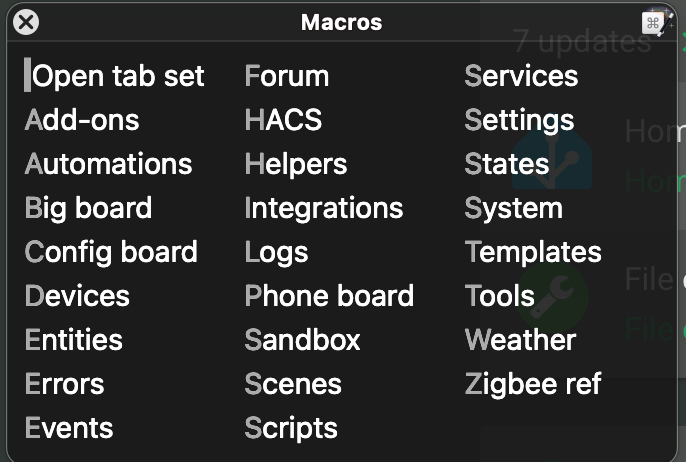

Here is an alternate approach, which may work better for some.
I routinely use a browser to interact with HA, which lets me use URLs to directly navigate to what I want. Plus, since I have Keyboard Maestro I can present them as a palette. Thus:
Huh, I should get rid of that title. I never noticed it before.
