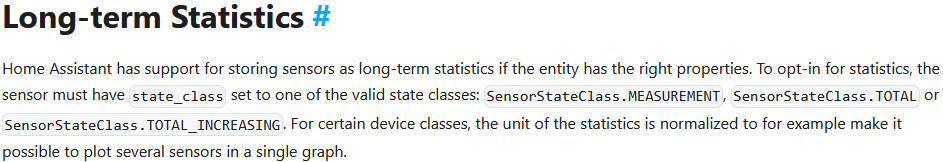

You don’t need measurement, you need statistics. Post the error message please. You likely need to use a different state class.

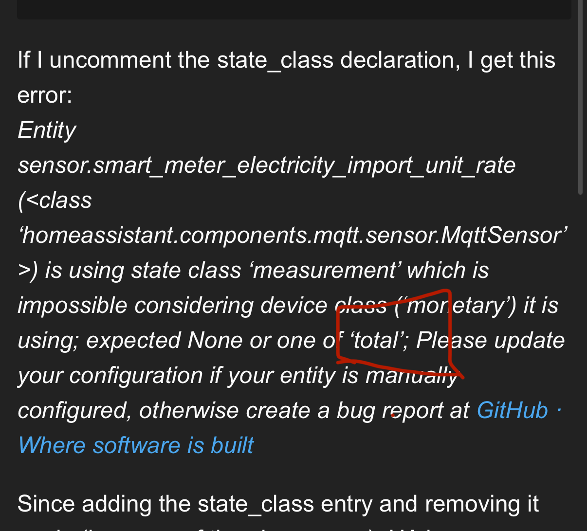

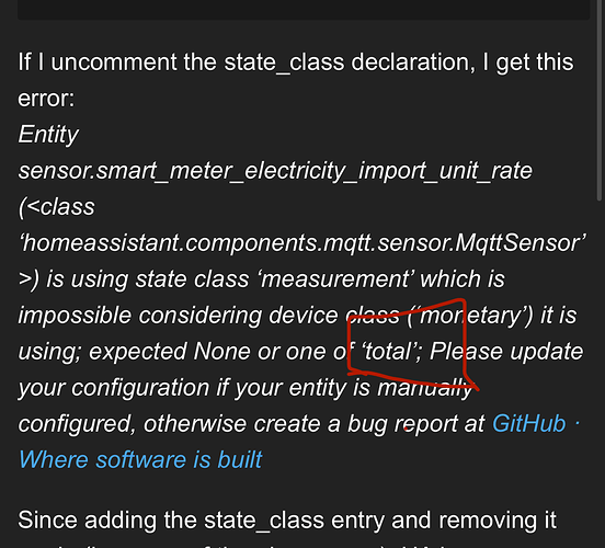

If I uncomment the state_class declaration, I get this error:
Entity sensor.smart_meter_electricity_import_unit_rate (<class ‘homeassistant.components.mqtt.sensor.MqttSensor’>) is using state class ‘measurement’ which is impossible considering device class (‘monetary’) it is using; expected None or one of ‘total’; Please update your configuration if your entity is manually configured, otherwise create a bug report at GitHub · Where software is built

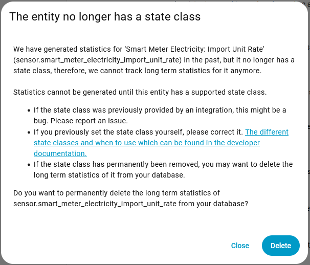

Since adding the state_class entry and removing it again (because of the above error), HA is now complaining and raising a repair…
So I need to set state_class to get long-term statistics, but then I get the error in italics above.
Use total, the error message says this.
