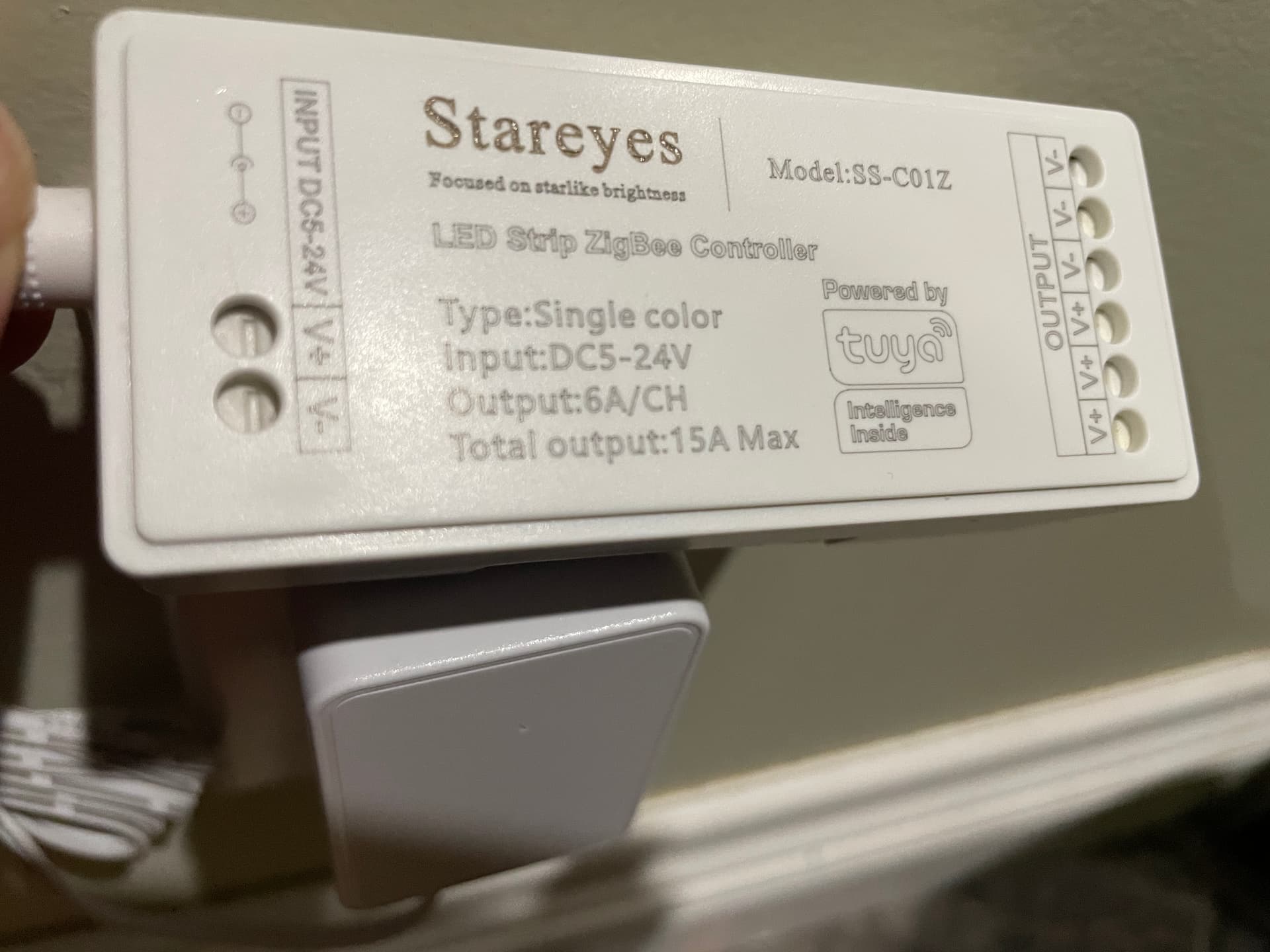

I have these Stareyes SS-C01Z LED Strip Controllers. The box says “Powered by Tuya” FWIW.
I can’t find a pairing or reset button. It went into pair mode on first power up, I don’t know how one would re-pair it.
The more pressing issue is missing entities. Shouldn’t there be one to dim the LEDs? The device has a quirk.

Looks like Stareyes cheaped out on the Set button so they could save a penny or 2 at your expense. If you’re feeling adventurous, pry open the cover and see if there’s a hidden microswitch. Hopefully, they didn’t cheap out on that too
If you’re still interested in getting the same model, this one has the Set button.
No idea if getting a replacement will fix your issue. FWIW, I had a look at the clusters which should be returned by that quirk, and you’re missing the LevelControl & Color clusters
