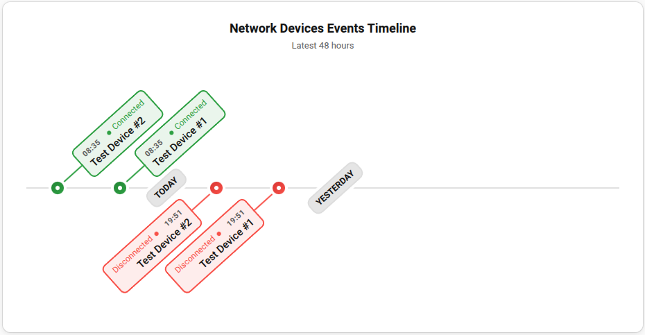

Timeline Card
A visual timeline card that shows when each monitored device went offline or came back online — great for spotting connectivity patterns or intermittent issues over time.

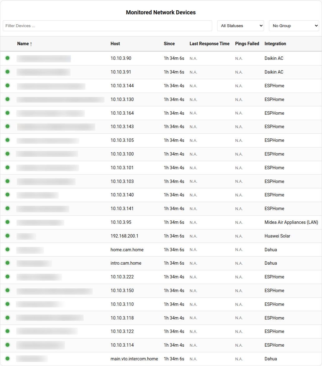

Table Card
A table view that shows all monitored devices with live status, last response time, ping failures, etc. Offers filtering and sorting, handy for quickly scanning network health — especially useful if you monitor many devices.

Well presented and easy to set up - thank you. I’m not getting anything on the timeline card, however. Installed through HACS - do I need to do anything else to get it going or does something actually have to go offline?
Thank you very much.
Well, the fact that you don’t see anything is a good sign :smile:
The timeline only shows device disconnection/reconnection events for the monitored devices.
If no device has gone offline since you activated the integration, it is normal not to see anything.

Regarding your question: the Timeline Card is designed to display events only. This means it shows devices when there is a state change (for example, from offline to online or vice versa). If a device has remained continuously online since the initial configuration, no event is generated, and therefore it does not appear in the timeline.
This behaviour is expected and by design.
