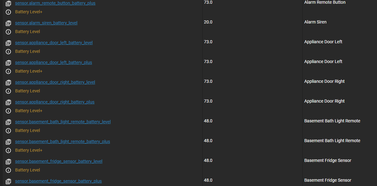

I also like this gem…
Obviously I can glean what the entity is related to by the entity id or the device column.
But I really don’t like the device and area columns as it takes up way too much space for the small benefit they give. well before the recent naming fiasco but now I guess I
m stuck with it.
and by looking at the names there I have no idea at all if they’ve been properly renamed or not. which forces me to click on every one of them and go to the entity settings to see what the real name of the entity is. Many of them aren’t named correctly to my naming convention and I didn’t notice until I added them to a dashboard card and the name showed up as some unwieldy monstrosity that required me to go and manually edit the name.
