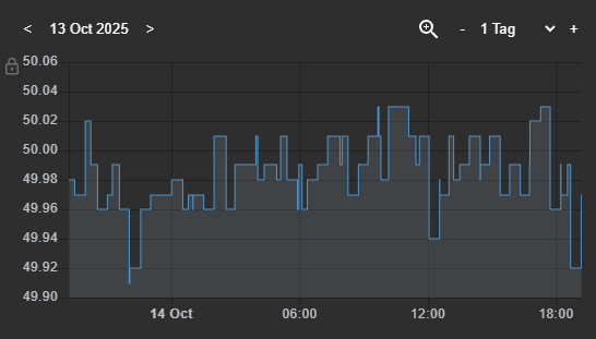

ThirdReality power monitoring zigbee plug has frequency. Don’t know if it updates fast enough to really diagnose issues with the power system, I might expect ‘electrical problems’ to be on pretty short timescale that might be missed.
Just found this, though
:man_shrugging: From what I can tell this is a pretty popular brand in the community. I’m sure for everything that’s ever been made you can find at least one person who has some horror story about a malfunction.
Plugs from Homematic have such sensors as well
