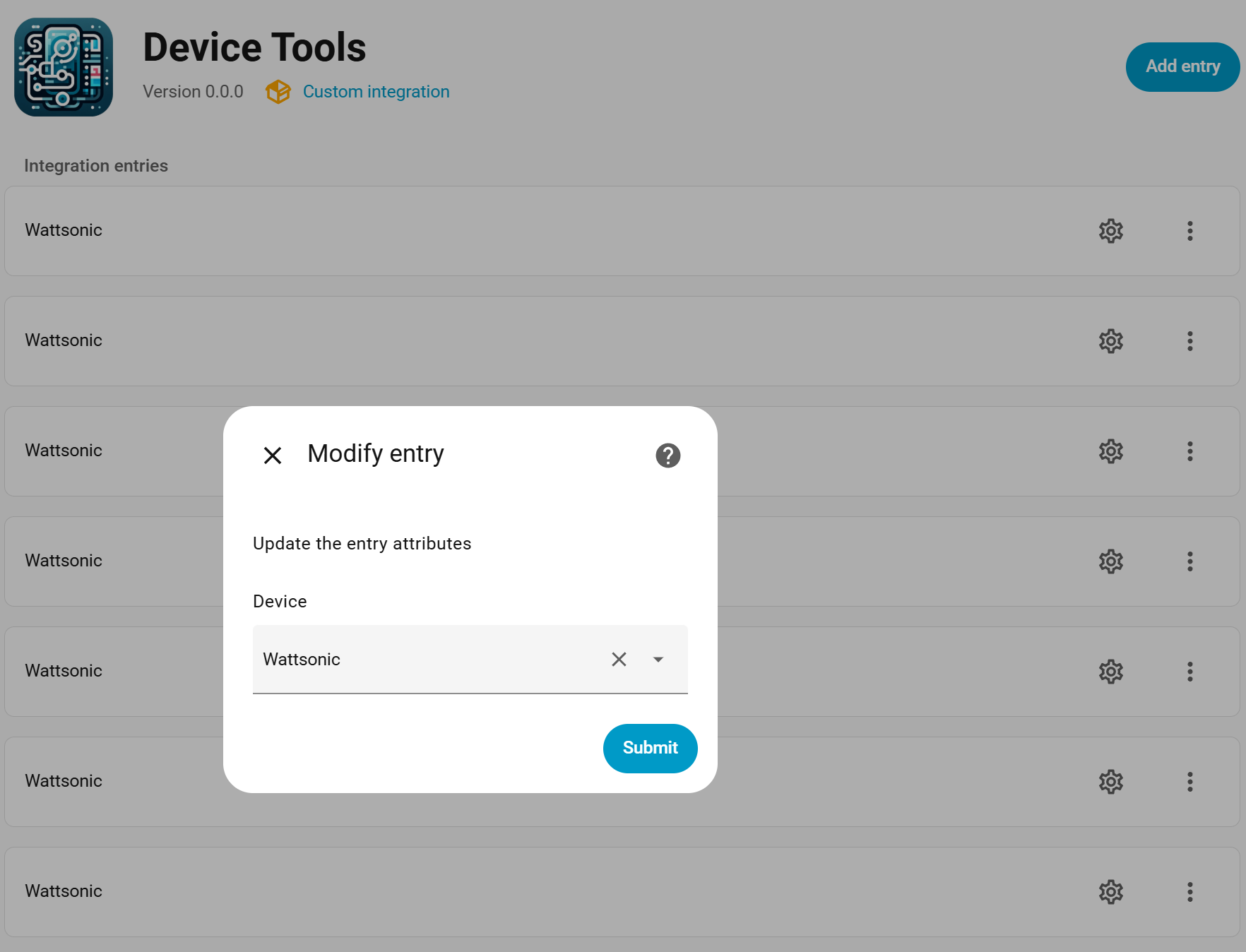

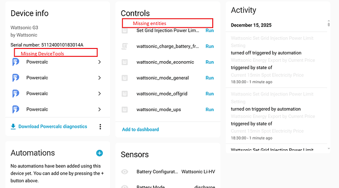

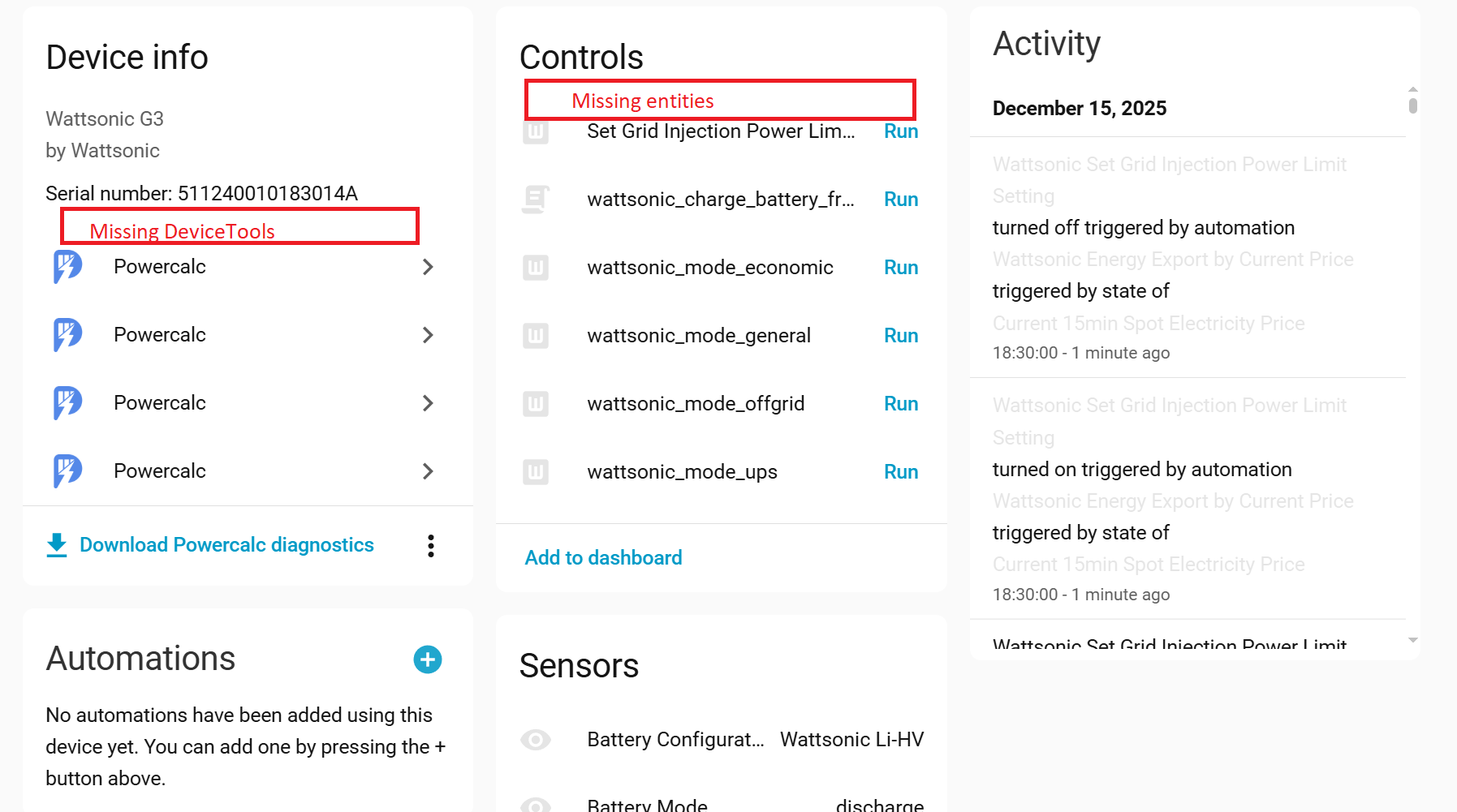

I’ve had my Wattsonic entities (dozens) integrated into a single device. After update to 2.0.1, it ended with Wattsonic device remained, but:
  1. Device Tools is not linked to it anymore
  2. Some entities are definitively missing.
  3. DeviceTools reports 35 entries, while there was only one Wattsonic only (see the second screenshot). All behave the same when opening its options
It’s OK with me to fix it on my own (eventually remove all and recreate the device). But if you like to take the opportunity to debug the migration, I can provide some data.
No info in logs (warning level) found.
BTW see the Version 0.0.0 on my screenshot. Maybe worth updating.

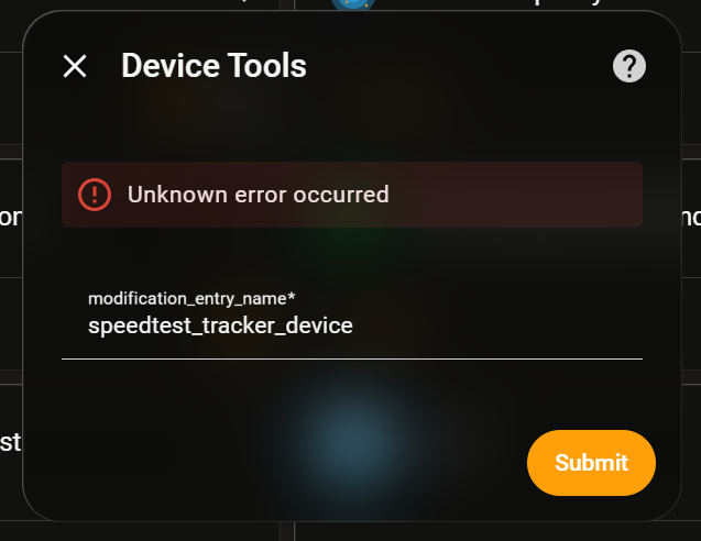

Im getting an error with 2.0.0-alpha whenever I try to create a new device. I leave the device selector empty, and enter a modification_entry_name and I get “Unknown error occurred” with the following in the logs:
2026-03-03 13:31:54.256 ERROR (MainThread) [aiohttp.server] Error handling request from 192.168.1.233
  File "/usr/local/lib/python3.13/site-packages/aiohttp/web_protocol.py", line 510, in _handle_request
    resp = await request_handler(request)
  File "/usr/local/lib/python3.13/site-packages/aiohttp/web_app.py", line 569, in _handle
    return await handler(request)
  File "/usr/local/lib/python3.13/site-packages/aiohttp/web_middlewares.py", line 117, in impl
  File "/usr/src/homeassistant/homeassistant/components/http/security_filter.py", line 92, in security_filter_middleware
  File "/usr/src/homeassistant/homeassistant/components/http/forwarded.py", line 87, in forwarded_middleware
  File "/usr/src/homeassistant/homeassistant/components/http/request_context.py", line 26, in request_context_middleware
  File "/usr/src/homeassistant/homeassistant/components/http/auth.py", line 242, in auth_middleware
  File "/usr/src/homeassistant/homeassistant/components/http/headers.py", line 41, in headers_middleware
    response = await handler(request)
  File "/usr/src/homeassistant/homeassistant/helpers/http.py", line 73, in handle
    result = await handler(request, **request.match_info)
  File "/usr/src/homeassistant/homeassistant/components/http/decorators.py", line 83, in with_admin
    return await func(self, request, *args, **kwargs)
  File "/usr/src/homeassistant/homeassistant/components/config/config_entries.py", line 234, in post
    return await super().post(request, flow_id)
  File "/usr/src/homeassistant/homeassistant/components/http/data_validator.py", line 74, in wrapper
    return await method(view, request, data, *args, **kwargs)
  File "/usr/src/homeassistant/homeassistant/helpers/data_entry_flow.py", line 121, in post
    result = await self._flow_mgr.async_configure(flow_id, data)
  File "/usr/src/homeassistant/homeassistant/data_entry_flow.py", line 336, in async_configure
    result = await self._async_configure(flow_id, user_input)
  File "/usr/src/homeassistant/homeassistant/data_entry_flow.py", line 383, in _async_configure
    result = await self._async_handle_step(
        flow, cur_step["step_id"], user_input
  File "/usr/src/homeassistant/homeassistant/data_entry_flow.py", line 483, in _async_handle_step
    result: _FlowResultT = await getattr(flow, method)(user_input)
  File "/config/custom_components/device_tools/config_flow.py", line 346, in async_step_create_entry
    return await self.async_step_modify_entry()
  File "/config/custom_components/device_tools/config_flow.py", line 435, in async_step_modify_entry
    for k, v in modification_original_data.items()
UnboundLocalError: cannot access local variable 'modification_original_data' where it is not associated with a value
