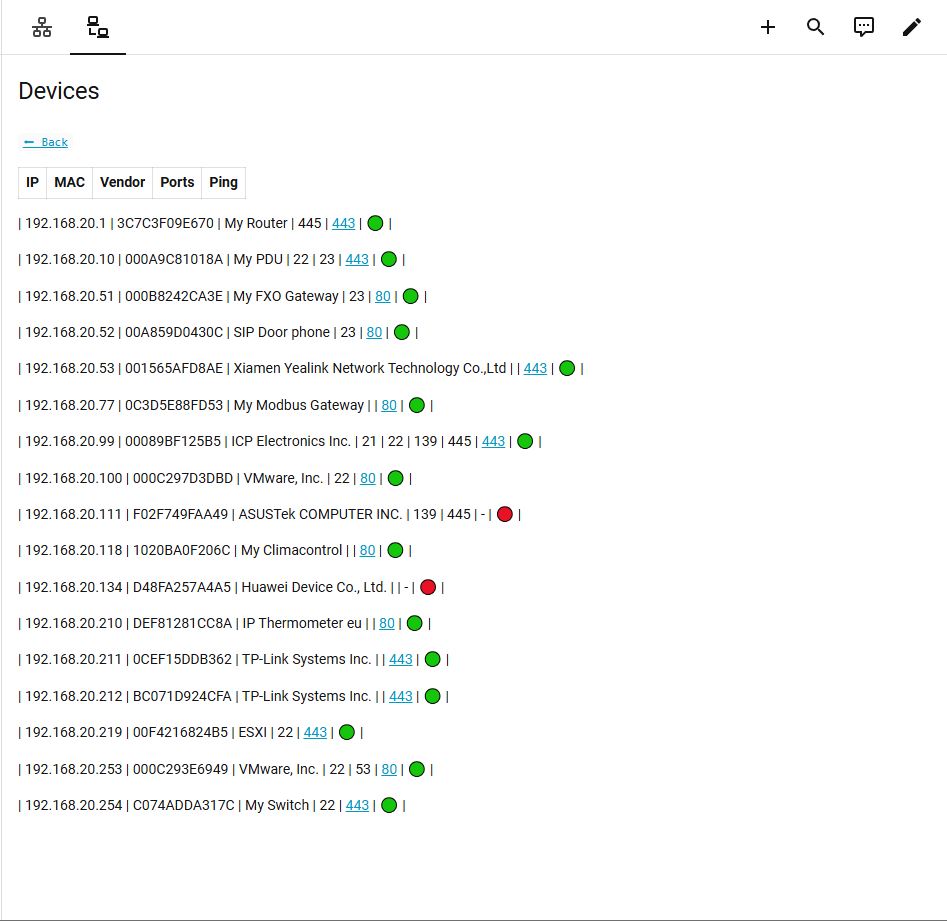

I note your presentation of the results is a delimited string, sorted by IP Address. Could it be tabbed or placed in columns that can be re-sorted by clicking the column heading?

This presentation is just a demo card available on my GitHub repository; it's the one I use because it suits my needs, feel free to create another one with the presentation of your choice.
