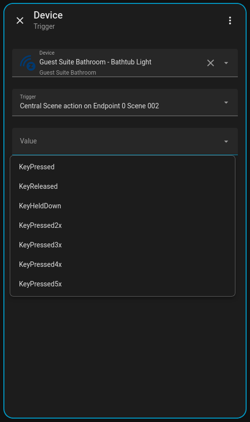

Please forgive me if I am in the wrong area for this post. I have discovered something that appears to be a bug and I don’t know where I should report this.
Anyway, today I was editing some of my automations and found that when I try to define a trigger for a Z-Wave switch, I can no longer set the Value using the drop-down that HA provides. The options are listed in the drop-down but when I select any one of the options nothing is retruned to the Value field. This used to work but now it doesn’t.
I have attached a screen shot of the dialog I am using:
No matter what I select, it is not displayed in the Value field. I have a number of automations that use the KeyPressed, and KeyPressed2x options. This has allowed me to control multiple things from a single switch. But now that seems to be broken.
When viewing the YAML for my automations, the “value:” entry under the “triggers:” section is now missing.
I can only assume that a recent update caused this as it used to work. Has anyone else experienced this?

alias: Master Suite Bathroom - Exhaust Fan Switch OFF 1X
description: Single-tap switch triggered automation that turns the exhaust fan OFF.
triggers:
  - device_id: 7f04ae2dec78a95031e29209596b0fdf
    domain: zwave_js
    type: event.value_notification.central_scene
    property: scene
    property_key: "002"
    endpoint: 0
    command_class: 91
    subtype: Endpoint 0 Scene 002
    trigger: device
    value: 0 <===== I added this line back into my YAML
conditions: []
actions:
  - action: script.1695752159108
    metadata: {}
    data: {}
mode: single
However, I edited the YAML and added the “value: 0” manually and now my automation is working. But when I try to edit the automation using the GUI the value is not shown in the Value field. And when I select a new value it is not displayed in the Value field.
I manually edited all of my other automations and now my system is working. I hope this is addressed in a future update.
