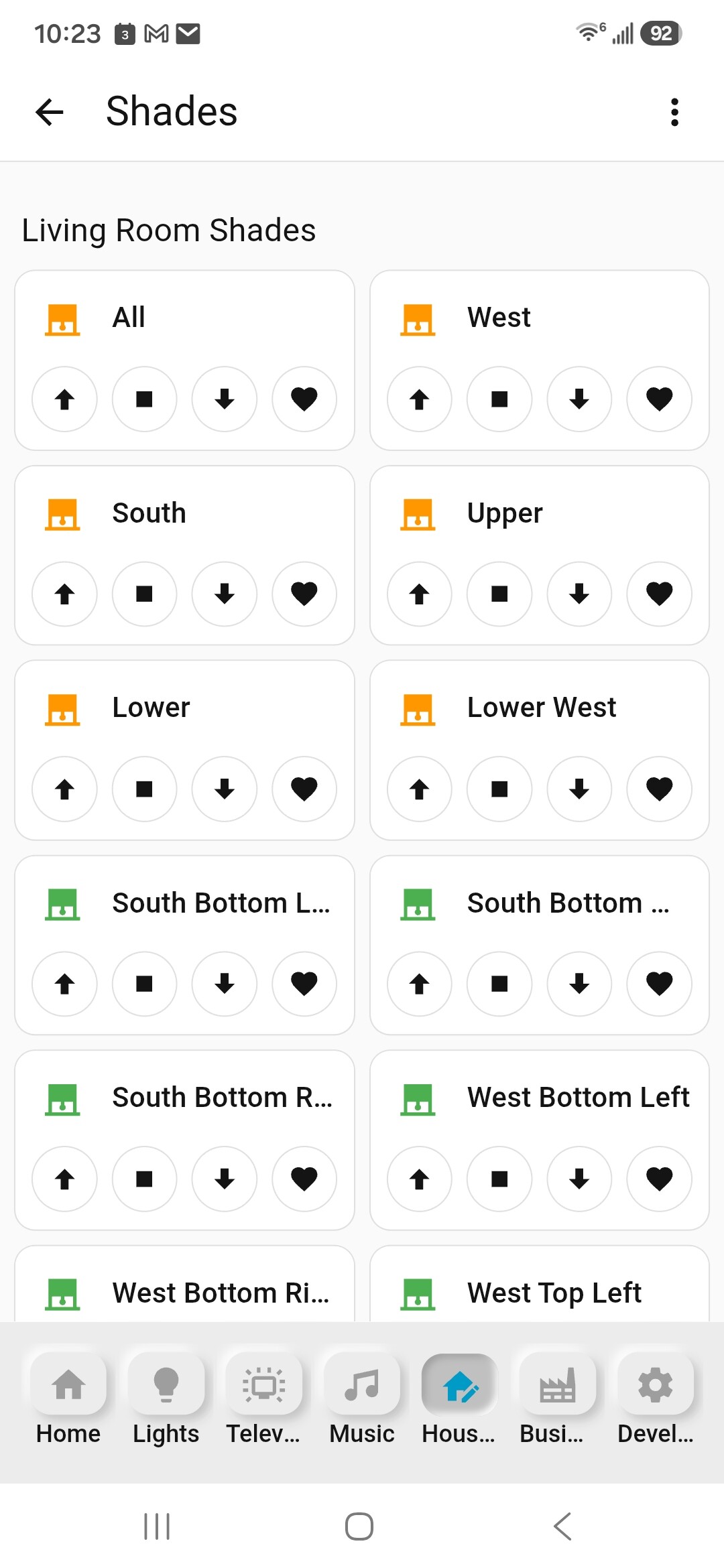

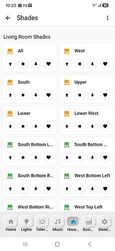

One thing I did not do as I find it unneeded is that you could map the commands and make a virtual cover. I find it much easier with decluttering card and variables. This decluttering is used for the shade and chips:
decluttering_templates:
  shadetemplate:
    default:
      - color: green
      - shade_name: All
    card:
      type: custom:mushroom-template-card
      primary: "[[shade_name]]"
      icon: mdi:roller-shade
      icon_color: "[[color]]"
      features_position: inline
      entity: binary_sensor.broadlink_shades
      tap_action:
        action: none
      double_tap_action:
        action: none
      hold_action:
        action: none
  shadechips:
    default:
      - remote: remote.broadlink_shades
      - shade_index: 5
    card:
      type: custom:mushroom-chips-card
      chips:
        - type: template
          icon: mdi:arrow-up-bold
          tap_action:
            action: perform-action
            perform_action: remote.send_command
              entity_id: "[[remote]]"
              num_repeats: 3
              delay_secs: 0.4
              hold_secs: 0
              command: Up[[shade_index]]
              device: Shades
          double_tap_action:
            action: none
          hold_action:
            action: none
        - type: template
          icon: mdi:stop
          tap_action:
              num_repeats: 3
              delay_secs: 0.4
              hold_secs: 0
              command: Stop[[shade_index]]
              device: Shades
          double_tap_action:
            action: none
          hold_action:
            action: none
        - type: template
          icon: mdi:arrow-down-bold
          tap_action:
              num_repeats: 3
              delay_secs: 0.4
              hold_secs: 0
              command: Down[[shade_index]]
              device: Shades
          double_tap_action:
            action: none
          hold_action:
            action: none
        - type: template
          icon: mdi:heart
          tap_action:
              num_repeats: 3
              delay_secs: 0.4
              hold_secs: 0
              command: Favorite[[shade_index]]
              device: Shades
          double_tap_action:
            action: none
          hold_action:
            action: none
      alignment: center
Then calling it is simple:
              - type: custom:decluttering-card
                template: shadetemplate
                variables:
                  - color: orange
                  - shade_name: South
                template: shadechips
                variables:
                  - shade_index: LowerSouth
