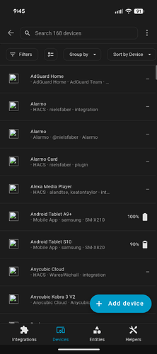

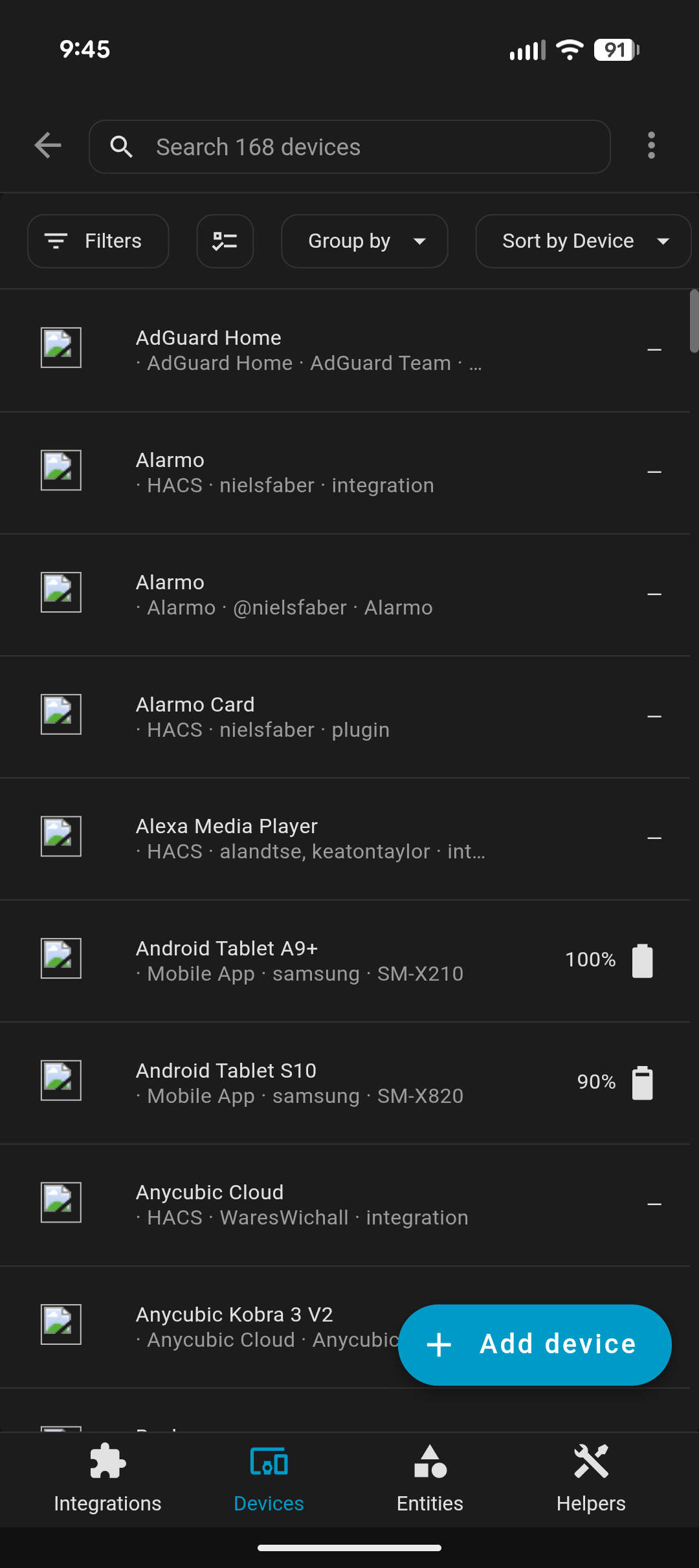

Anyone else having this issue? Only happens on Mobile Devices. All the icons are gone

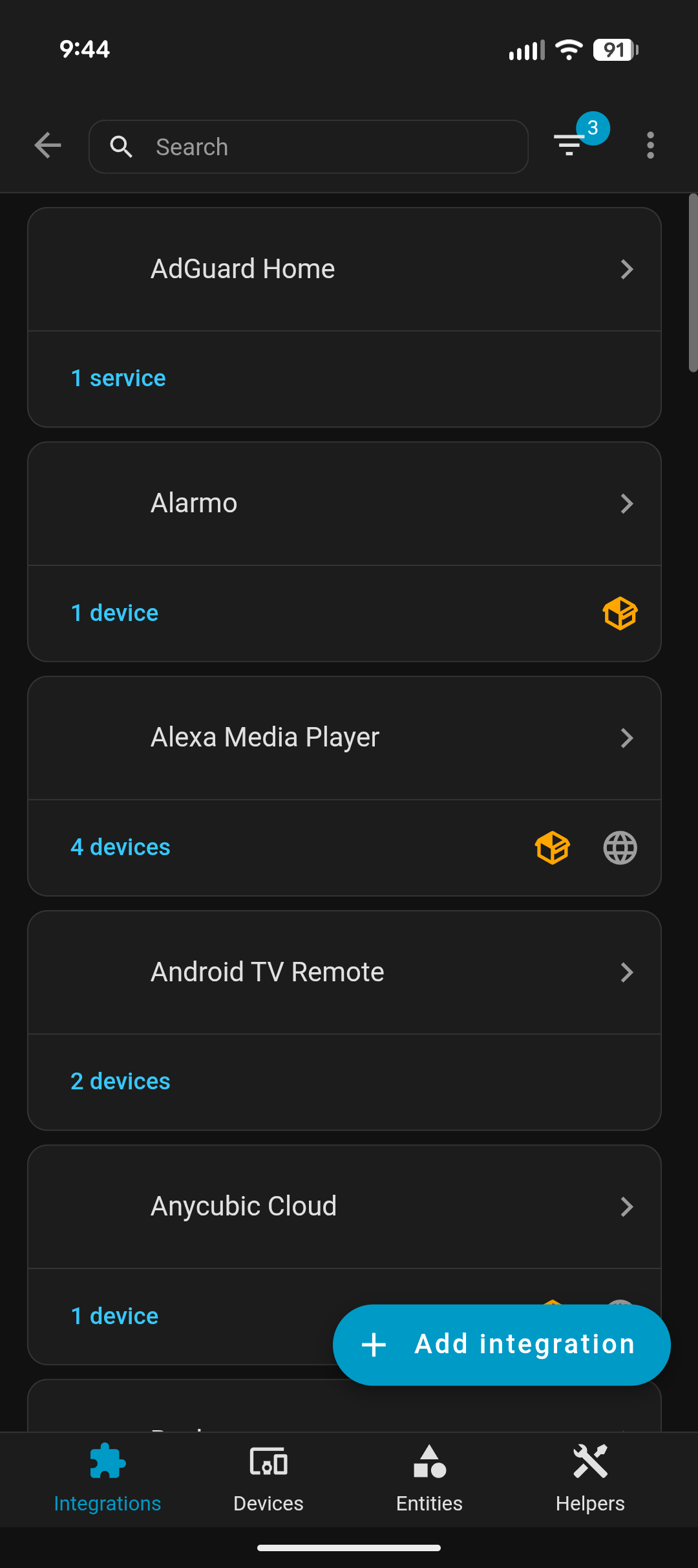

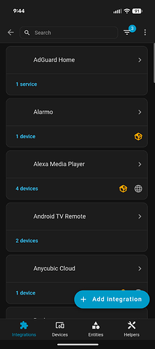

I thought maybe this was an issue in general. Yes I have refreshed, cleared cache, restored to an older version. Uninstalled and reset up. This happens on all Android and Ios devices. I also have 2 instances. On at my primary and vacation house. Both the same. Also if I go to the webpage no issues. But if I install it as an app on the home screen it has the same issue. It seems as though it has something to do with full screen?
Also this only happens on Devices and Services… Apps, automations, people… Everywhere no issue. Only the icons are missing there and devices page.

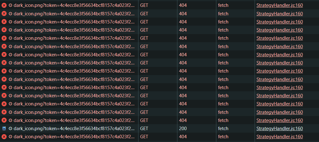

When I look at the network calls of the frontend, I can see a bunch of 404 responses. Seems like most integrations don’t have a dark_icon, so they can’t show anything in dark mode. It’s a bit weird that the light mode icons are not used as a fallback.
