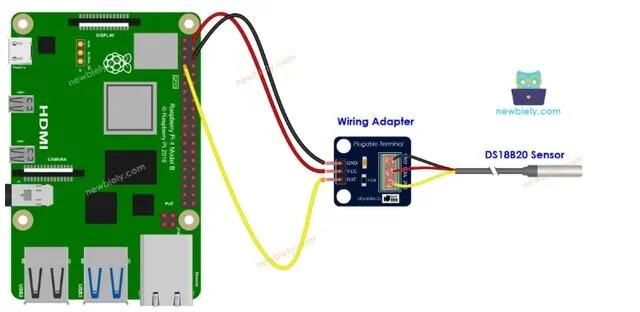

The first downside, is it uses the same GPIO pins as the display shown above. The second, is there would be significant handwaving to get the temperature sensed into HA. I’m not averse to going through the exercise, but with two roadblocks already, I’m wondering if there is a better solution.
Any ideas of a sensor that could be used in this instance with ready (easy) integration with both the Pi and HA?
