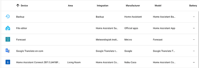

The ZBT-2 device does show in the settings (!!) but not in the areas or in the device overview.

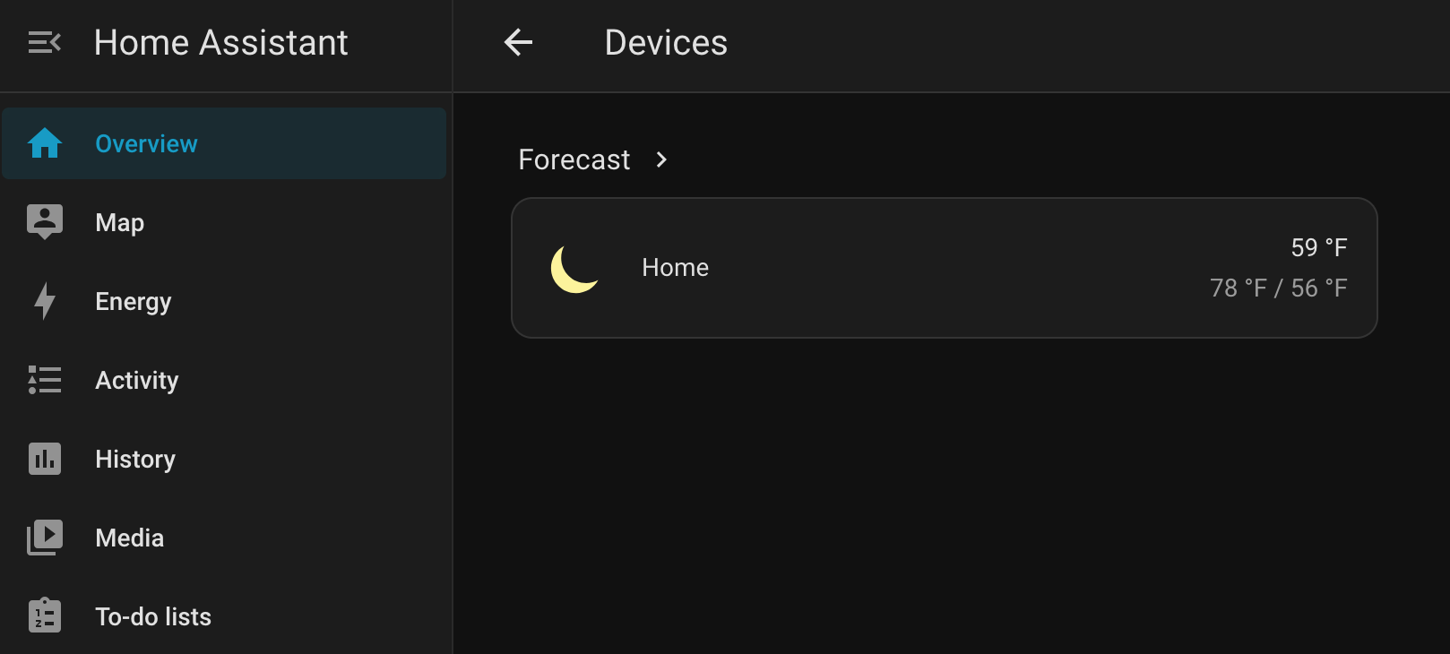

Not showing up in device overview:

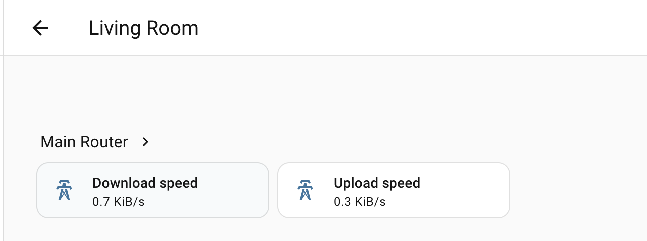

Not showing up in Living Room:
But is configured to be in the Living Room in the Settings → Devices (!!)

That Overview dashboard is automatically generated & you don’t have much control over what is shown there. Much simpler to create your own dashboard & have full control over what is (and isn’t) displayed.
The Problem is you haven’t learned how the Builtin-Dashboards Works.
It Populates the Device-View with All Devices which are Not in an Area
( Notice the small text, top-right of each Device, Add to an Area )
When you do that it will be visible in The respective Area( And no longer under Devices ), if you don’t it will stay put under " Other - Areas - Devices "

Ok, I think I figured this out. The “Living Room” from the Overview only shows the entities in each of the devices. The ZBT-2 does not have any entities associated with it.
So if I click on the “Living Room” in the overview, I only see the router.

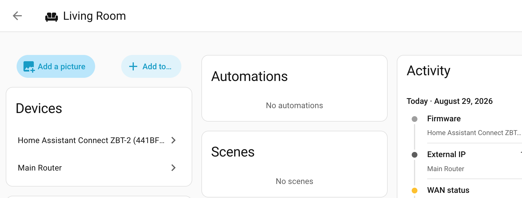

But if I click on that device, and then on the “In Living Room”, I see both devices.
I don’t quite know a better way to reach this view of the Living Room area, and the OpenThread Border Router is not working, but at least there is progress.
Yup, that works! I still can’t see the ZBT-2 properly with the OTBR, but I will file another issue for it.
