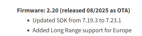

I have asked several manufacturers. Zoos replied and confirmed that they will equip their 800 devices with EU LR. This can hopefully be done via OTA, but will still take some time.
grafik
Greetings Oliver
P.S. A Razberry 7 pro (external antenna - 700 series) has an approx. 10 db better background RSSI than the ZAC93. I will therefore try to add an external antenna .

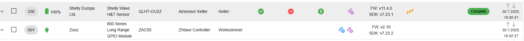

Today I’ve included my first Z- Wave EU LR device. It’s a Shelly H&T Sensor (QLHT-OU2Z).
Shelly seems to be the first company to offer various LR devices.
The first tests are simply outstanding. The range has been massively increased compared to standard Z-Wave Plus devices. My controller (Zooz ZAC93 with external antenna) is located in the center of the house. Even 4-5 solid concrete walls across floors are no longer a problem. The signal was still received about 150m outside the house.
Now I urgently need plug sockets with Z-Wave LR. I would prefer a firmware update for the Zooz ZEN15 plug :wink:
I really think this could give Z-Wave in Europe a boost, as it means that radio problems are a thing of the past.
