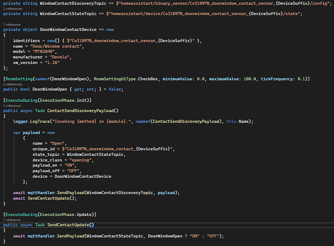

Hi everyone,
I’m working on a project in which I am using MQTT to fake devices in Home Assistant. I created a fake Devolo door/window contact sensor but it won’t update the state. The state always shows ‘unknown’. Does enyone have a idea how I can fix this? I am using the code below.
