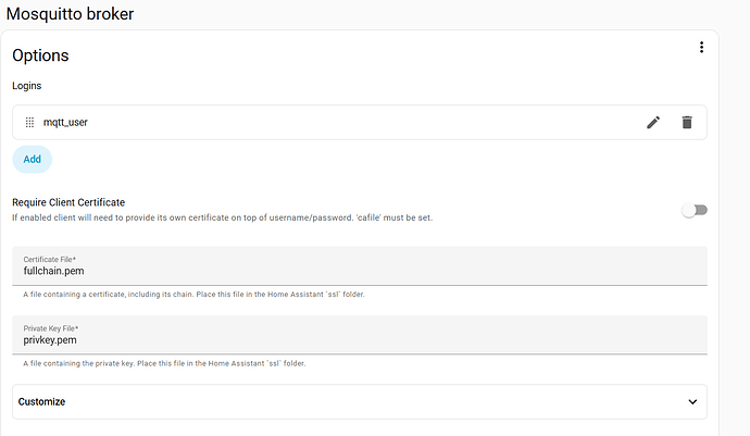

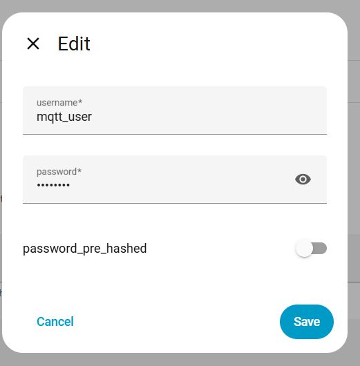

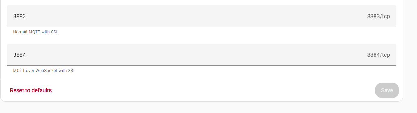

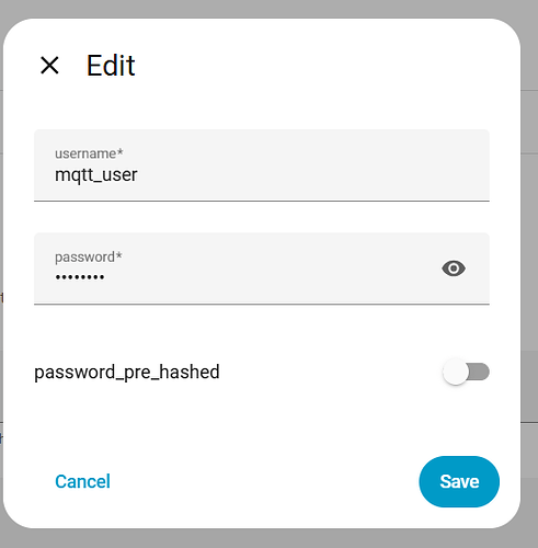

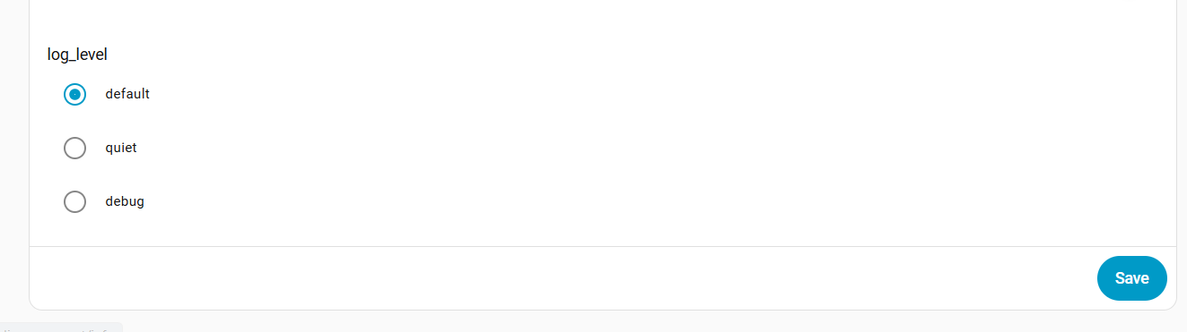

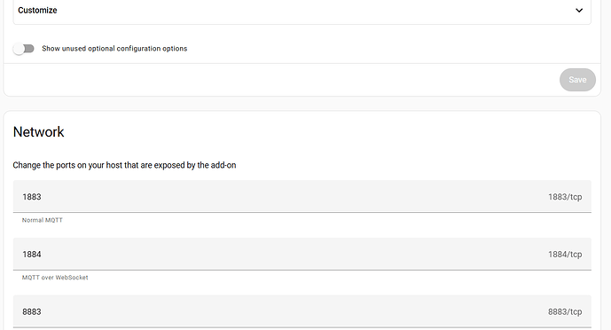

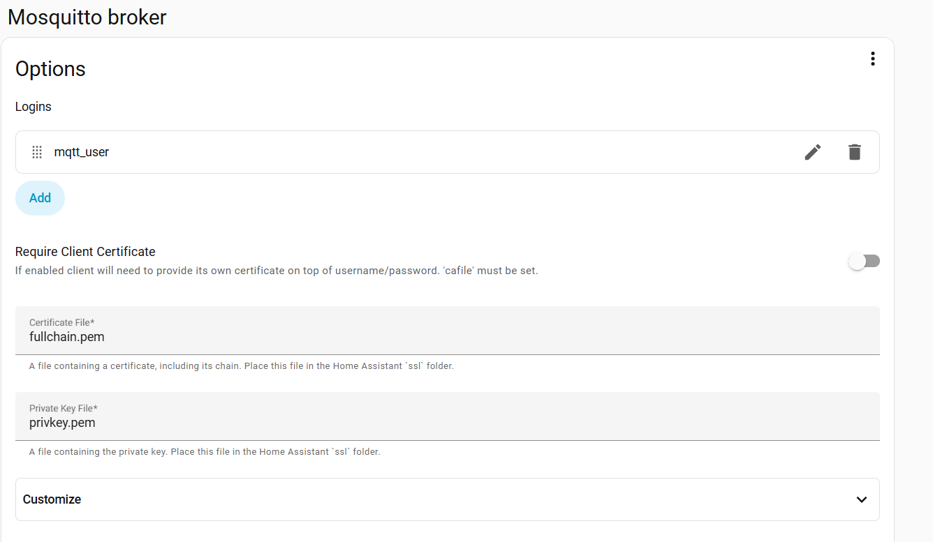

  1. Sounds good. Here is the Mosquitto broker add on configuration in 3 screenshots
Under customize (not shown in the screen shots above), I have active turned off since when it is on, I can’t connect to MQQT Explorer).
And this is the logins section. Didn’t see anything related to anonymous access other than Require Client Certificate, which is turned off.

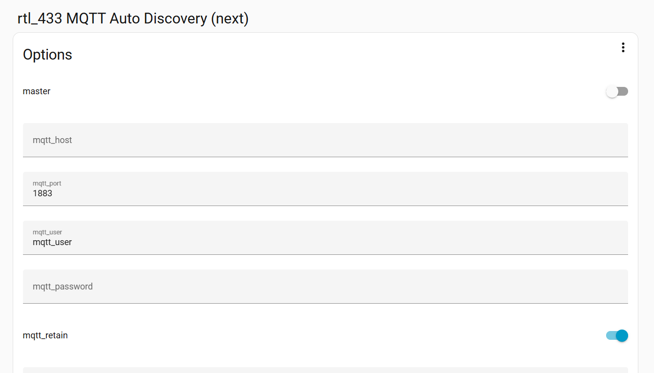

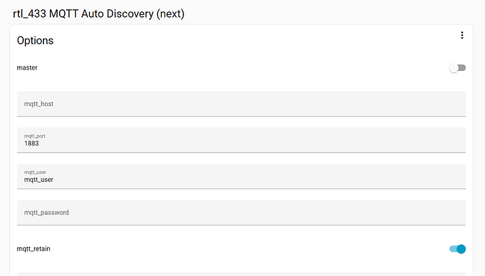

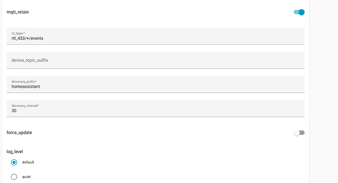

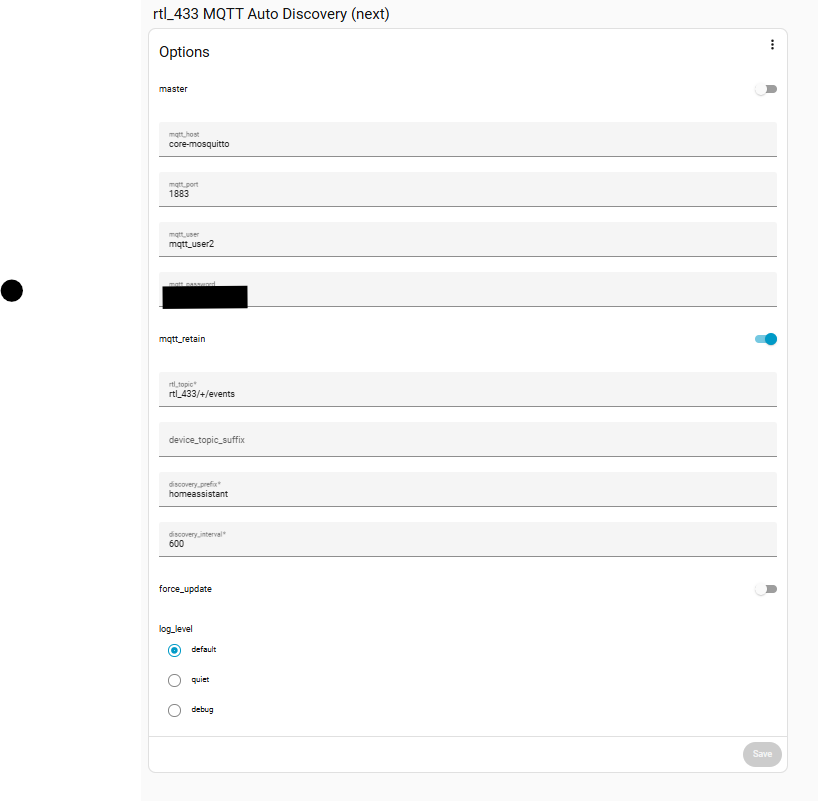

  1. Here are the rtl_433 MQTT Auto Discovery (next) add-on → Configuration screenshots

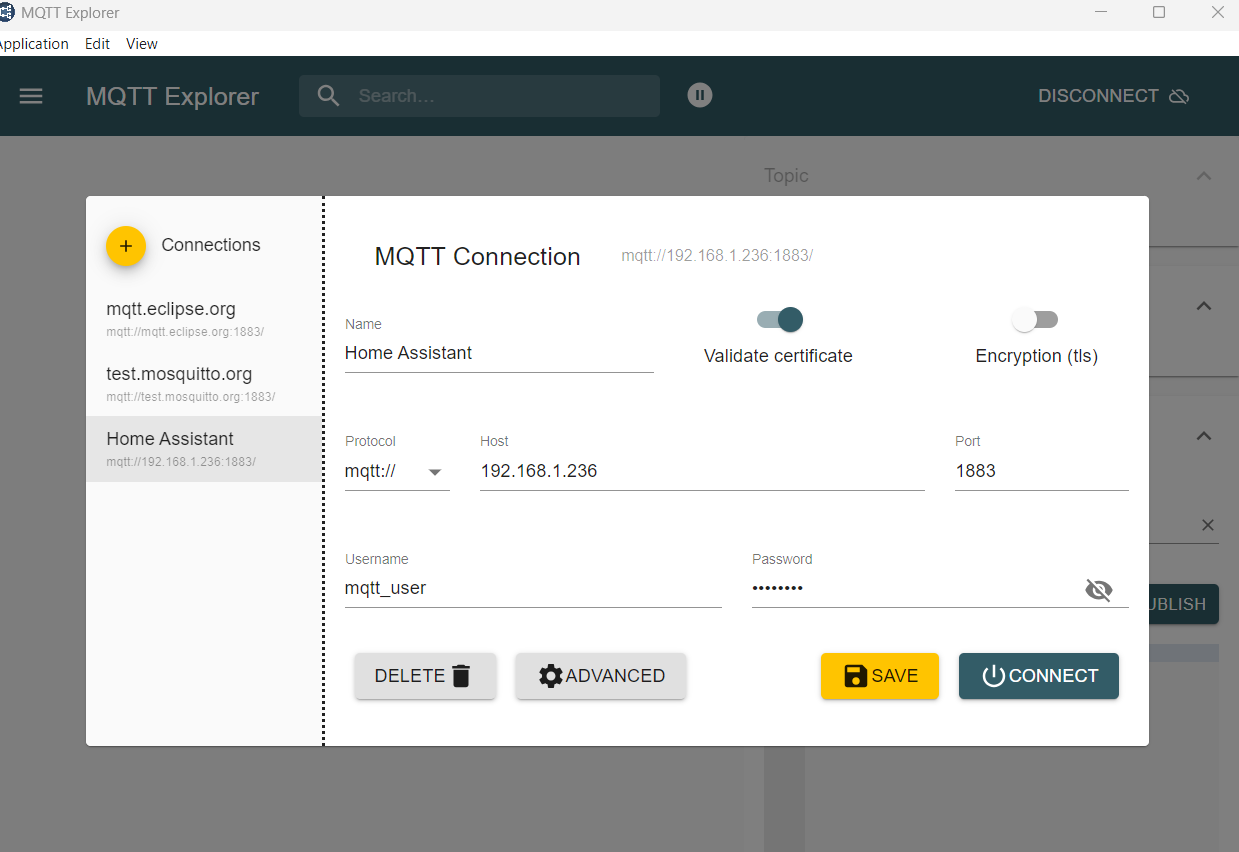

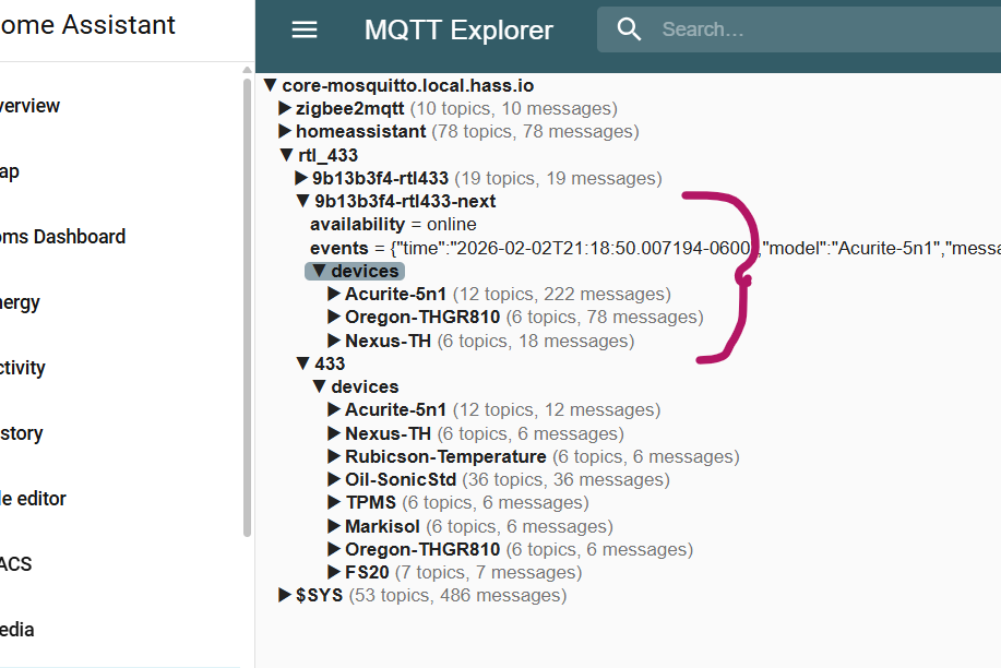

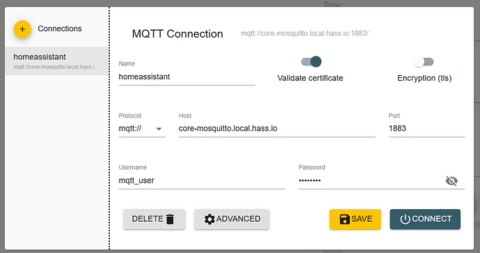

Here is the host MQQT Explorer host info
How do I find the MQTT Explorer IP/hostname and port?

I forgot I also have MQTT Explorer installed on my Windows machine (HA is running on an NUC). Here is a screenshot of its settings and even with the IP address as indicated, the rtl devices do not update. Maybe that is another clue.
Awesome, thanks, this is exactly the info we needed. Your Mosquitto login setup looks correct.
The key thing you’re missing is the hostname context:
core-mosquitto (and core-mosquitto.local.hass.io) only works from inside Home Assistant add-ons.
MQTT Explorer running on your Windows machine must connect to your Home Assistant IP or hostname, not core-mosquitto.
So, please do this:
  1. MQTT Explorer on Windows
    Host: 192.168.1.128 (your HA IP)
    Port: 1883
    Username: mqtt_user
    Password: the same password you set in Mosquitto
    TLS: off
  2. rtl_433 MQTT Auto Discovery (next) add-on
    This add-on runs inside HA, so it should use:
    mqtt_host: core-mosquitto
    mqtt_port: 1883
    mqtt_user: mqtt_user
    mqtt_password: same password
Save and restart the rtl_433 MQTT Auto Discovery (next) add-on.

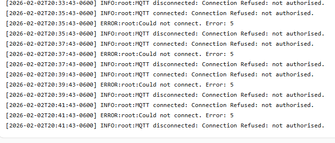

[2026-02-02T08:59:16-0600] INFO:root:Discovering all devices
[2026-02-02T08:59:17-0600] INFO:root:MQTT connected: Connection Refused: not authorised.
[2026-02-02T08:59:17-0600] ERROR:root:Could not connect. Error: 5
[2026-02-02T08:59:17-0600] INFO:root:MQTT disconnected: Connection Refused: not authorised.
[2026-02-02T08:59:18-0600] INFO:root:MQTT connected: Connection Refused: not authorised.
[2026-02-02T08:59:18-0600] ERROR:root:Could not connect. Error: 5
[2026-02-02T08:59:18-0600] INFO:root:MQTT disconnected: Connection Refused: not authorised.
[2026-02-02T08:59:20-0600] INFO:root:MQTT connected: Connection Refused: not authorised.
[2026-02-02T08:59:20-0600] ERROR:root:Could not connect. Error: 5
[2026-02-02T08:59:20-0600] INFO:root:MQTT disconnected: Connection Refused: not authorised.
[2026-02-02T08:59:24-0600] INFO:root:MQTT connected: Connection Refused: not authorised.
[2026-02-02T08:59:24-0600] ERROR:root:Could not connect. Error: 5
[2026-02-02T08:59:24-0600] INFO:root:MQTT disconnected: Connection Refused: not authorised.
[2026-02-02T08:59:32-0600] INFO:root:MQTT connected: Connection Refused: not authorised.
[2026-02-02T08:59:32-0600] ERROR:root:Could not connect. Error: 5
[2026-02-02T08:59:32-0600] INFO:root:MQTT disconnected: Connection Refused: not authorised.
[2026-02-02T08:59:48-0600] INFO:root:MQTT connected: Connection Refused: not authorised.
[2026-02-02T08:59:48-0600] ERROR:root:Could not connect. Error: 5
[2026-02-02T08:59:48-0600] INFO:root:MQTT disconnected: Connection Refused: not authorised.

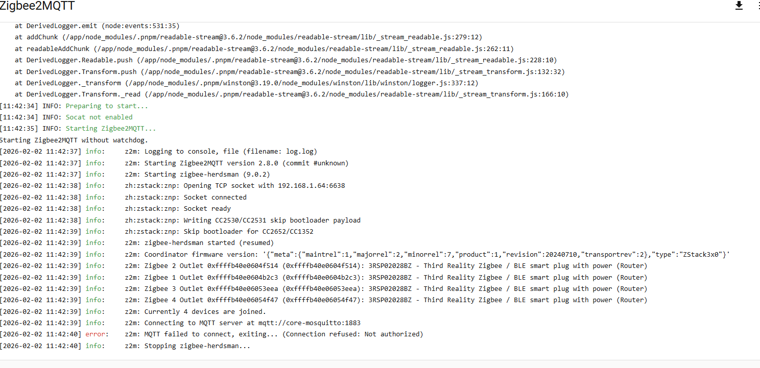

Because of that , I also checked some other things. Zigbee also is not working sinced the restore. Here is the Z2M log file:

[2026-02-02 08:53:12] info: 	z2m: Connecting to MQTT server at mqtt://core-mosquitto:1883
[2026-02-02 08:53:12] error: 	z2m: MQTT failed to connect, exiting... (Connection refused: Not authorized)
[2026-02-02 08:53:12] info: 	z2m: Stopping zigbee-herdsman...

STEP 1 – Create ONE known MQTT login in Mosquitto
Mosquitto broker add-on → Configuration → Logins → Add
Username: mqtt_user
Password:
Save, restart Mosquitto.

STEP 4 – Update rtl_433 MQTT Auto Discovery (next)
In that add-on Options:
mqtt_port: 1883
mqtt_password:
Save and restart the add-on.

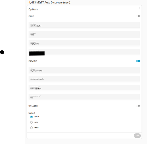

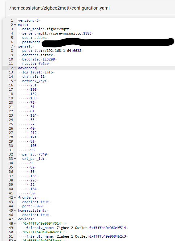

I already had an mqtt_user, so I deleted that and created a new user mqtt_user2, which I also added under People. I added that user to Mosquitto and MQTT. In Zigbee configuration.yaml the user was addons and the pw was extremely long, like 50 characters. Using File editor, I changed them to the mqtt_user2 and my password. Zigbee still won’t start. It runs for a second and then stops. When it does, it also changes to user and password back to what it was. (Z2M was stopped when I made the changes so that can’t be why it reverted. I checked after I saved it and it was correct but reverted only when I tried to start Z2M)
Zigbee ran fine before the backup/restore, and my user info hadn’t changed, that’s what is so frustrating. One thing I just noticed in Z2M configuration, all of the fields in the mqtt drop down are empty. Is that right? Even though the configuation.yaml file had most of that filled in.
So nothing has changed, messages do not update. Here is the log showing the not authorized error.
I will hold off reinstalling HA (I really don’t want to anyway), but since we verified the user information is consistent across all add ons, what do you think about reinstalling the add ons? My thinking is that something got corrupted during the restore. If it seems like a logical step, which one would you try first? Either that, or there is some little switch or setting that I am missing.
This is a good clue. Two important things:

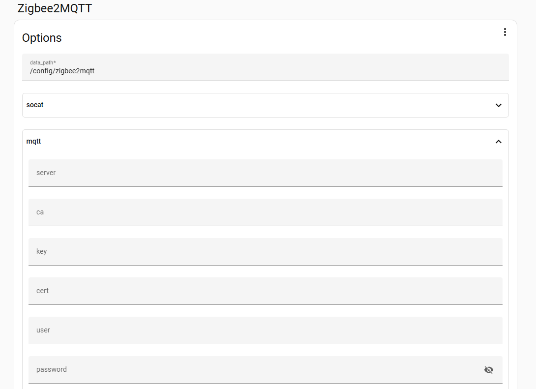

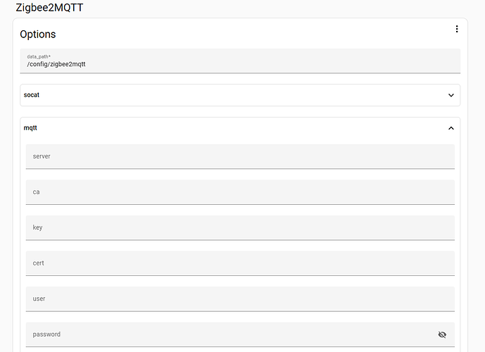

  1. Your Z2M config keys look wrong
    In your screenshot you have top-level keys like:
    mqtt_user:
    mqtt_password:
Zigbee2MQTT does NOT use those keys. It expects credentials under the mqtt: block:
mqtt:
server: mqtt://core-mosquitto:1883
user: mqtt_user2
password:
If the keys are wrong, Z2M will ignore them, connect without the right creds, and you’ll get “Not authorized”.
  1. The “reverting” behavior usually happens when config is being managed in a different place
    If you edit one file (File Editor) but the add-on UI manages another config source, your changes won’t stick or will be overwritten.
Recommended fix path:
A) In the Zigbee2MQTT add-on UI, expand the “mqtt” section and fill in:
  • server: mqtt://core-mosquitto:1883
  • user: mqtt_user2
  • password:
    Save, then restart Z2M.
OR (if you prefer file-based):
B) Edit the actual Zigbee2MQTT config file used by the add-on:
it is usually /config/zigbee2mqtt/configuration.yaml
Make sure it contains the exact block above (mqtt: → user/password), then restart the add-on.
After restart, Z2M logs should show it connected to MQTT (no “Not authorized”).
Once Z2M is fixed, apply the same idea to rtl_433 (next): it must use the exact same mqtt_user2/password as Mosquitto.
After editing, open the file again and confirm the contents are still there BEFORE starting Z2M. If it changes on start, then the add-on UI is overwriting the file and you should only configure MQTT via the add-on UI.
Okay some good news! Zigbee is working now after entering the credentials and server info in the UI. Thank you! However, rtl_433 is not updating. It is still showing unauthorized in the logs (for auto discovery). Here is the log file for rtl_433 (next)

I’m wondering if this is the wrong way to enter the credentials into /homeassistant/rtl_433/rtl_433.conf.template (it is what I found on line). Without the output line, I got nothing, and found it was needed. But maybe it is calling the wrong username and password.
output mqtt://${host}:${port},user=${username},pass=${password},retain=${retain}

Here is the rtl_433 Auto Discovery (next) file. Since it is an authorization problem, I verified several times that the passwords and user names match.
And for completeness, here is the log for rtl_433 Auto Discovery (next) with the same error.
More good news. I pulled the plug (literally) on the NUC running HA and rebooted. Probably not the best way to restart, but now when I listen to rtl_433/# in MQTT, it gets updated regularly. Yay! Also the authorization errors in the log file are finally gone!
I still can’t see any updates in MQTT Explorer. Maybe my settings are wrong? Also, I don’t get any messages when listening to rtl_433/433/devices/Nexus-TH-1/92/temperature_C, but I have to go back and see if we deleted that.
UPDATE: i actually can see some topics being updated, but not where I expected. Previously, they would update under the 433 subfolder, but now they appear in the area highlighted. So more good news.

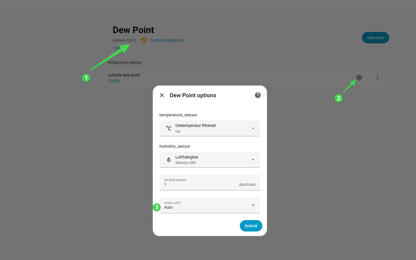

  1. Update the Dew Point integration to the latest version.
  2. In the Dew Point config, select your real temperature sensor (the one that shows 70.xx °F), no template conversion needed.
  3. Set output unit to Auto (or choose °F explicitly).
  4. Remove/disable the “Nexus TH Temperature Fixed” template sensor afterwards if you don’t need it anymore.
With 70°F and 20% RH, a reasonable dew point is around ~24°F (≈ -4°C), not ~98°F. After the update you should be in that range.

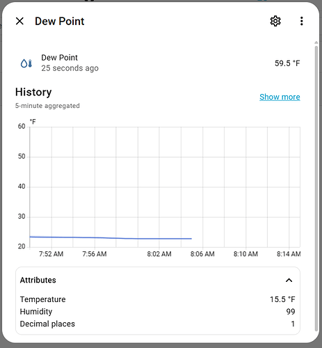

Wow, that was fast! I am having trouble updating the integration, though. I followed the instructions on Github using HACS, but the interface looks the same, even after a restat. I don’t see any option to set units to auto. Also, the calculation isn’t deriving the correct dew point. However, if I set C as the units, then it reports a dew point of 15C. That value would be about right if it was in F.
The termperature attribute is also wrong. The sensor display shows 64F, and MQTT Explorer also shows it at 64, but the integration thinks it is 15.5F. That would be almost correct if it were in C but it should be more like 17.7. I have set it to use the actual sensor data, not the template. The humidity seems reasonable at 99 as that is what the sensor’s display is reporting.

Go to the setting - devices and the Dew Point, make sure you are on the right version
One more thing based on your latest screenshot.
Right now the main problem is not the dew point formula, it’s that the integration is reading the wrong temperature value:
Your sensor display shows ~64°F, but Dew Point attributes show 15.5°F.
So the Dew Point config is either pointing to the wrong temperature entity, or the selected entity has a different “native” unit/value than what the UI is displaying.
Can you paste these two items (copy as text from Developer Tools → States):
  1. The exact entity_id you selected as temperature_sensor in the Dew Point config.
  2. The full state + attributes for that entity (especially unit_of_measurement, state_class, device_class, and any “temperature”/“native_value” fields if present).
Quick check:
In Developer Tools → States, does that temperature entity’s STATE show 64, or does it show ~15.5?
If it shows ~15.5, then it’s actually reporting in °C (15.5°C ≈ 60°F) or it’s a different sensor than you think.
If it shows 64, but Dew Point reads 15.5, then we’re not actually using the entity you think, or there’s an entity registry duplicate.
Also, “Auto” output unit only appears in the latest integration version and only inside the config entry settings (gear icon) as in my screenshot. If you don’t see it, please confirm the integration version shown on Settings → Devices & Services → Dew Point.

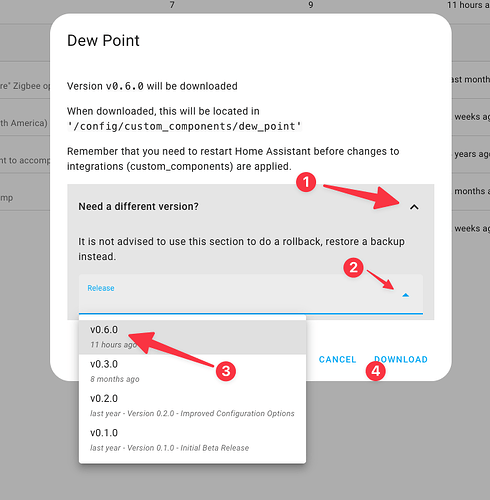

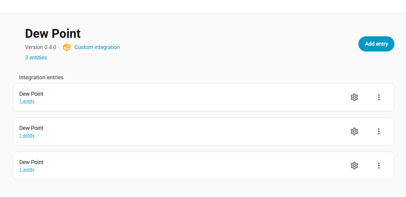

My bad. I am still using V 0.4 and I see that the latest on Github is 0.6. But I’m still stuck on how to update. I go to HACS, clcik 3 dots, custom repostitories, paste the url GitHub - Nicxe/Home-Assistant-Dew-Point: A sensor for dew point in Home Assistant and click add. Then I click on add configuration button on the github page
When I go to integrations, there is the Dew Point with 3 entities now, but the version shows still 0.4.
Sorry for being such a dunce. Once I get the latest version, I’ll continue with the diagnosis.

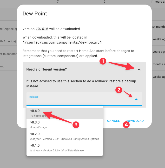

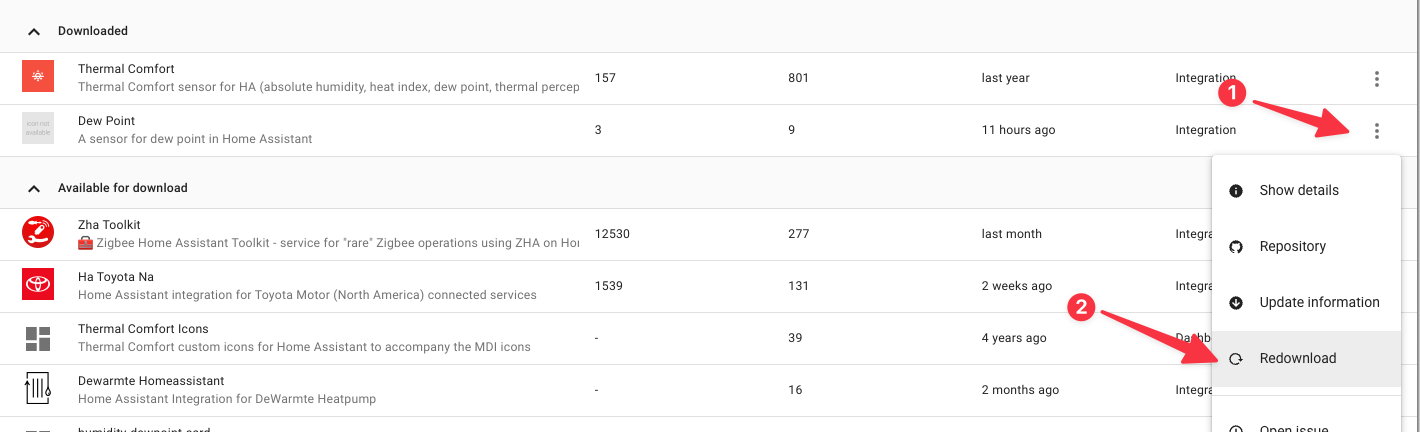

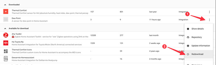

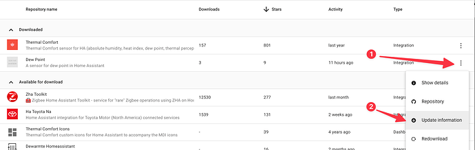

Two options, update information and HACS will understand there is a new version
Or manually download it
The first option didn’t work. Updated information but still shows V0.4, even after a restart. Then it disappeared after restart, so I added it again to custom repositories. But redownload worked like a charm and as soon as I entered the sensor data, it gave me the dew point as expected and I didn’t have to change anything. If you want to see any of my screens, let me know. BTW, I left output units set to ‘auto’.
