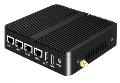

In my case for example I’m using a miniPC like this one:
and one port is connected to the first home network, while the second port connects to the security cameras (for Frigate) and they live in a different, isolated network.
Both are now served by the same DHCP server with my dnsmasq-dhcp addon :slight_smile:

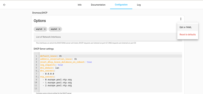

I hope you solved your configuration issues but based on your last answer I think there was a misunderstanding. I meant to say: edit the addon config locally with your editor and then copy-paste it to the HomeAssistant UI.
You can copy-paste the full addon config if you hit the “Edit in YAML” option in the top-right corner of the “Options” pane, see screenshot:
