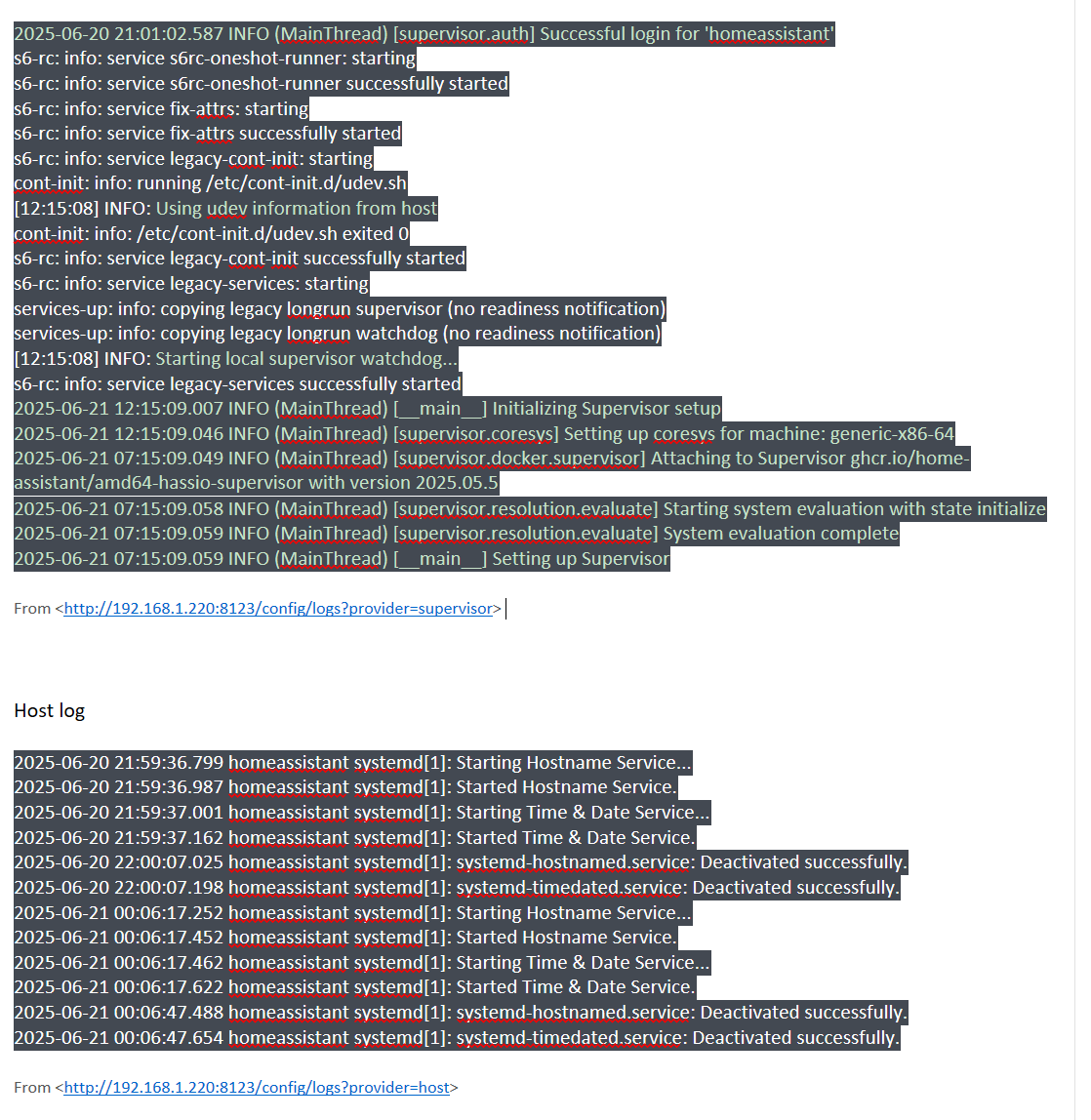

I have a native install of the HAOS with Frigate.
Occasionally, I find the system has hung and all I can do is reboot the hardware.
For example, you can see below a big gap in the supervisor and host logs from the evening of June 20 until I rebooted around 7AM on June 21.
Any insights from these logs? Any advise on where else to look?
/homeassistant/home-assistant.log is not showing anything prior to the restart of the hardware.
THANKS!
