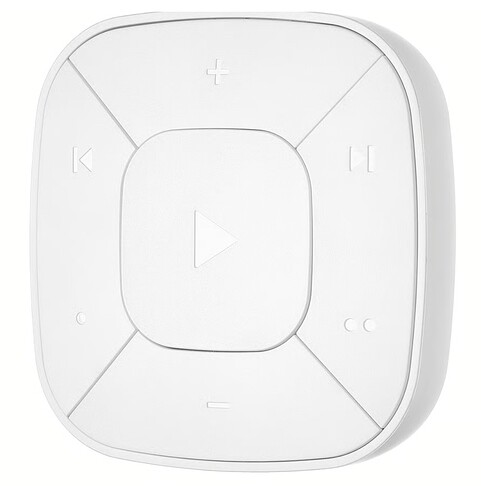

Did anybody find good music remote?
So with IKEA and Sonos parting paths, I cannot buy any symfinisk device anymore where I live.
I could get by buying some more expensive speakers, but what I miss more is symfinisk music remote controller. I tried to search but did not find anything that came remotely (pun intended) close to the OG IKEA remote.
Did anybody had some more luck?
I really like the possibility to play/pause manage volume skip songs forward and back and some more buttons (I assigned custom playlists to those) without needing to open app directly on the wall in the room where I have the speakers.
