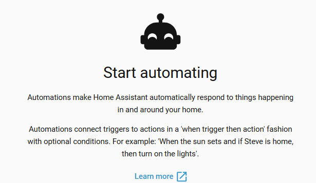

Isn’t check config automatic with a restart? I am pretty sure I did a restart after moving the automations.yaml file and removing the include line. But I tried again and definitely restarted Home Assistant and got the “Start Automating” page.
But with the include line pointing to configuration/automations.yaml shows me all 220 automations.
