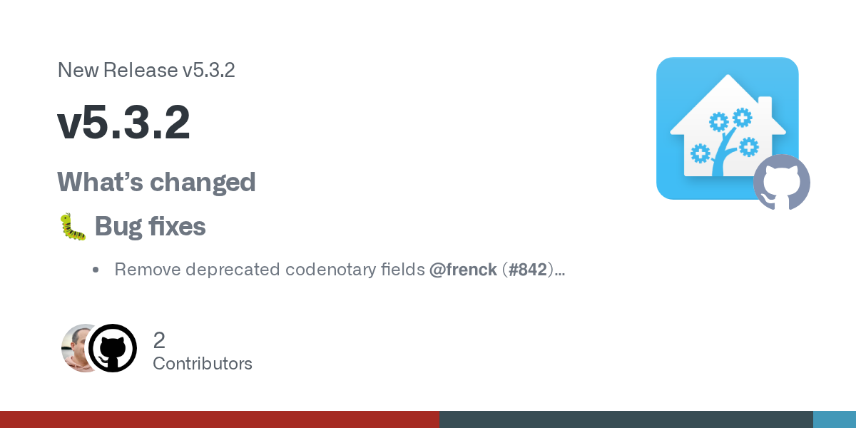

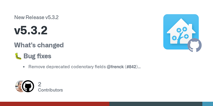

5.3.2 is the latest version of the add-on, which it appears you are using.
That’s what’s confusing me. Isn’t the add-on zwave-js-ui which is 11.6.1?
No, the latest version of the add-on is v5.3.2. v11.6.1 is the Z-Wave JS UI version.
