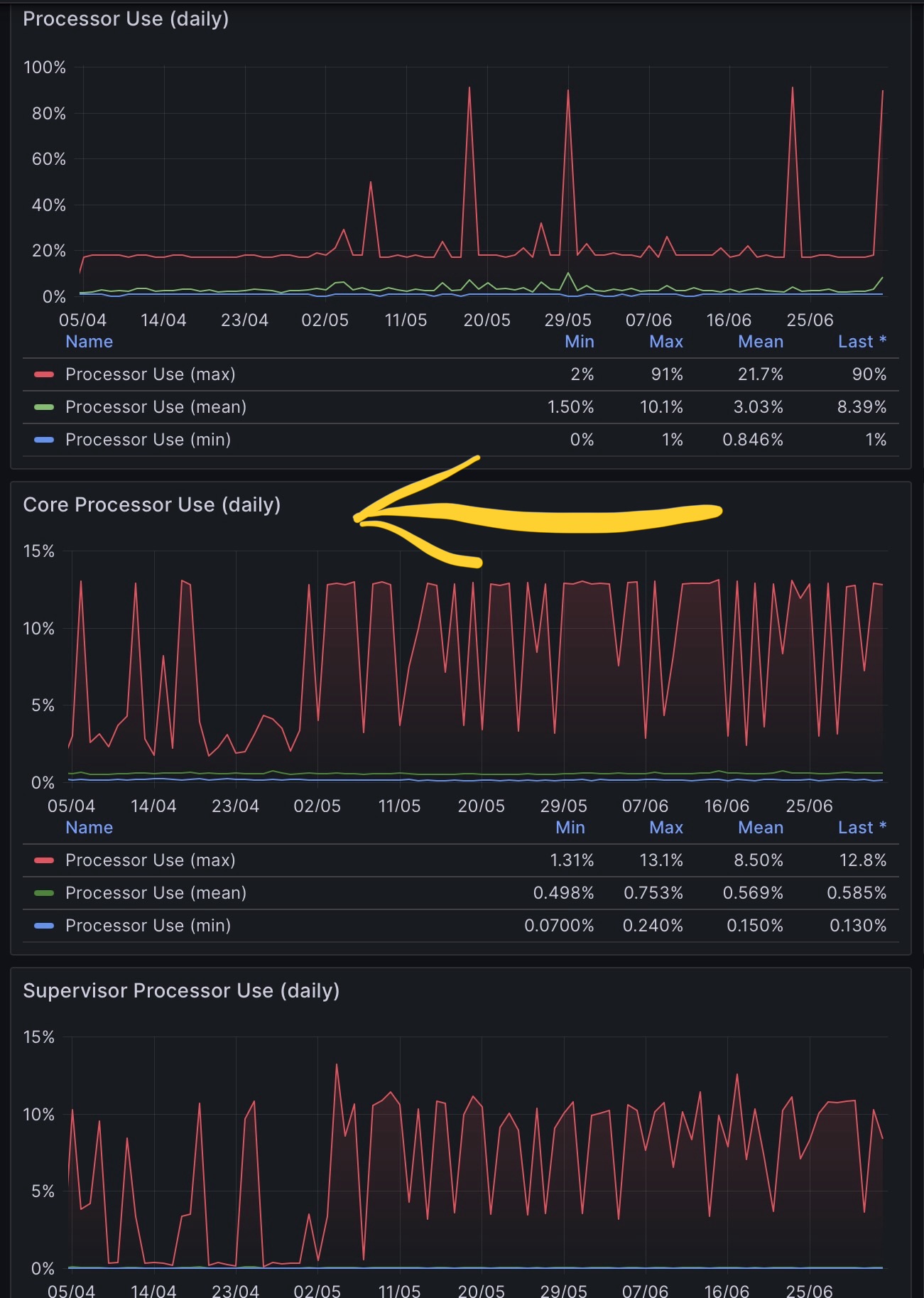

My guess is you are only seeing the core container utilisation in your sensor.
Do you have manny app (add-on) containers?
They would not be included in your sensor.
e.g. your sensor only shows this
Where as Proxmox shows the top graph.
Also the VM will only see the tics it has available, so tics used for Proxmox and virtualization of the VM will not be present inside the VM.
Many modern BIOSes have settings for virtualization and these should be enabled. They enable direct access to some resources that takes a lot of power to emulate otherwise.
