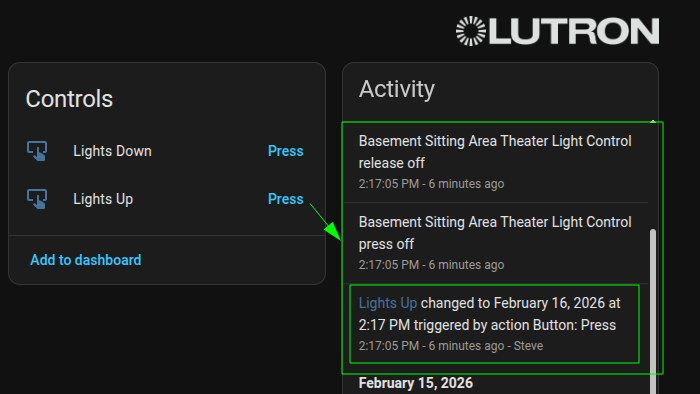

When I use the blue “Press” button on the Controls card of the Device page I see entries in the Activity log like:
Note the 3rd activity “Lights Up” then there are what I would call two “events” for button press and button release.

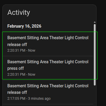

Compare that to what I see when I press the “off” button on the physical remote, this is what I see in the Activity:
The same two “events” (makes sense) but not the “Lights Up” entry.
So my first question would be: Can anyone explain why there are different activities logged when the button is pressed in the UI versus on the physical device?

To answer your question though, yes, I believe my Automation is designed and built to take into account the necessary actions and permutations. However, I based this on access to the “Mystery Event Raised when the Press button is press” from an Entity State Trigger, but that doesn’t seem possible.
This all comes back to the fact that the physical button presses don’t raise the same events as the software/UI button presses and that seems wrong to me. I’ve looked through the code and nothing obvious is jumping out at me.
I can fix my integration in 2 minutes by changing from State Triggers to Device Triggers. It just annoys me because it doesn’t seem like that should be necessary and makes me suspect I’m missing something.

It is so that you can distinguish between a physical action, an automation, or a dashboard. See: How to use context
This can be quite handy. e.g. A light that is activated by movement (automation) may have different actions than if you pressed the physical button, like not turning off automatically if it was a physical press, only for movement.

The Best way to know your Device, ( and integration ) Is, Open Developer-Tools in 1 view, and Device-Page in another.
Then Click/Press a button, se what happens in Dev-Tools vs Activity, and Release, do same. Some seems like “Actions” (state change) and other is “Events” which is/can be 2 different things.
That you have this “peculiar” “Press”, could be that your “Button/Remote” have i.e a “Hold” feature, but maybe the integration don’t support this
So my suggestion is , read up upon Your device, and Use Dev-Tools to understand how it works in the Integration/HA
A “Press” is usually an Event, like Hold/Release, an Action is a State-change.
An i.e Remote-Button register an Event, the Device it’s “Conneted/Binded To” Register A State Change (Action)
In other words, The (Event) Press(on the remote-button), triggers a State-Change on the “connected” Device (Action)

They fire an event, so when you Press, it goes from “Release Off” to Press, and when you Release it goes back “Press Off”, 2 events fired, 3rd is the Action performed (lights UP) Thou it could have said to What ?
If you HOLD your Button Down for 3 seconds, you should see this in the activity, and the 3rd come immediately after you Release
