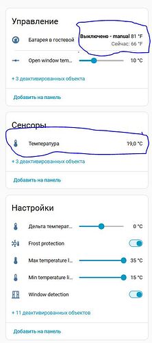

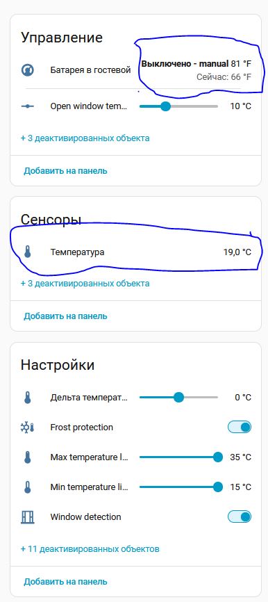

I would ask You about support/recomendation in follow case. I have installed TRV26 (Avatto) and integrated by Zigbee2mqtt. I set measuring unit in Sensor in C (Celsium). But in control (Climate) still unit Fahrenheit. See attached screen.
What can be problem and possible to change to all in Celsium?

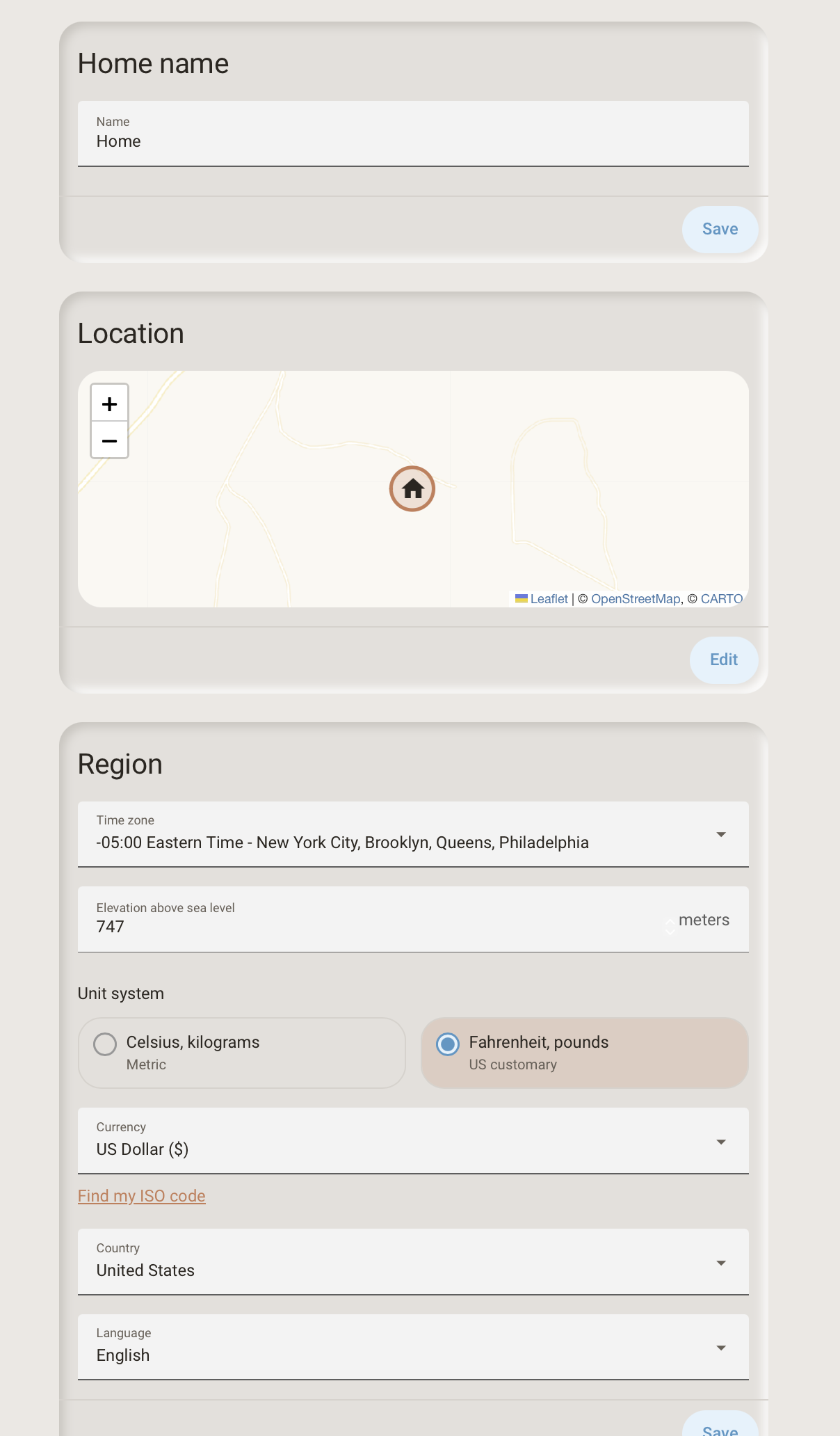

Is your System->Home Information->Region set correctly?
Dear Bob,
On this page i can’t to change somthing (see attached screen).
The system write comment -
You cannot change these settings in the UI, as you have config stored in ‘configuration.yaml’ under the ‘homeassistant’ key.
