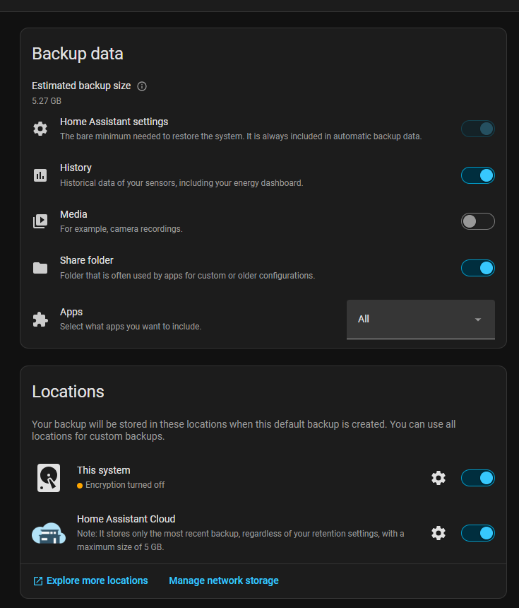

Hi everyone, just looking for some advice, I was checking my backup settings and I noticed some discrepancy with backup sizes.
When I look at the automatic backup options, I get an approximate size of 5.7GB for the backup, however when look at the recent automatic backups created with the same settings, they are 1.7GB each. All are set to exclude media and include all apps.

Thanks Tom, could I just clarify this, these are my automatic backup settings:
I went and ran an automatic backup now to test:

Still just confused as to why it’s so much smaller in size?
because the files are compressed…
Both backups are compressed. That does not explain the difference in size.
Full probably includes your media folder.
You can download the backups and open them with 7zip, or winrar to see what is inside.
Okay Tom thank you, I will take a look inside.
Full did include the media folder, which is full of frigate media, thanks for your guidance.
