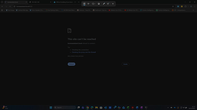

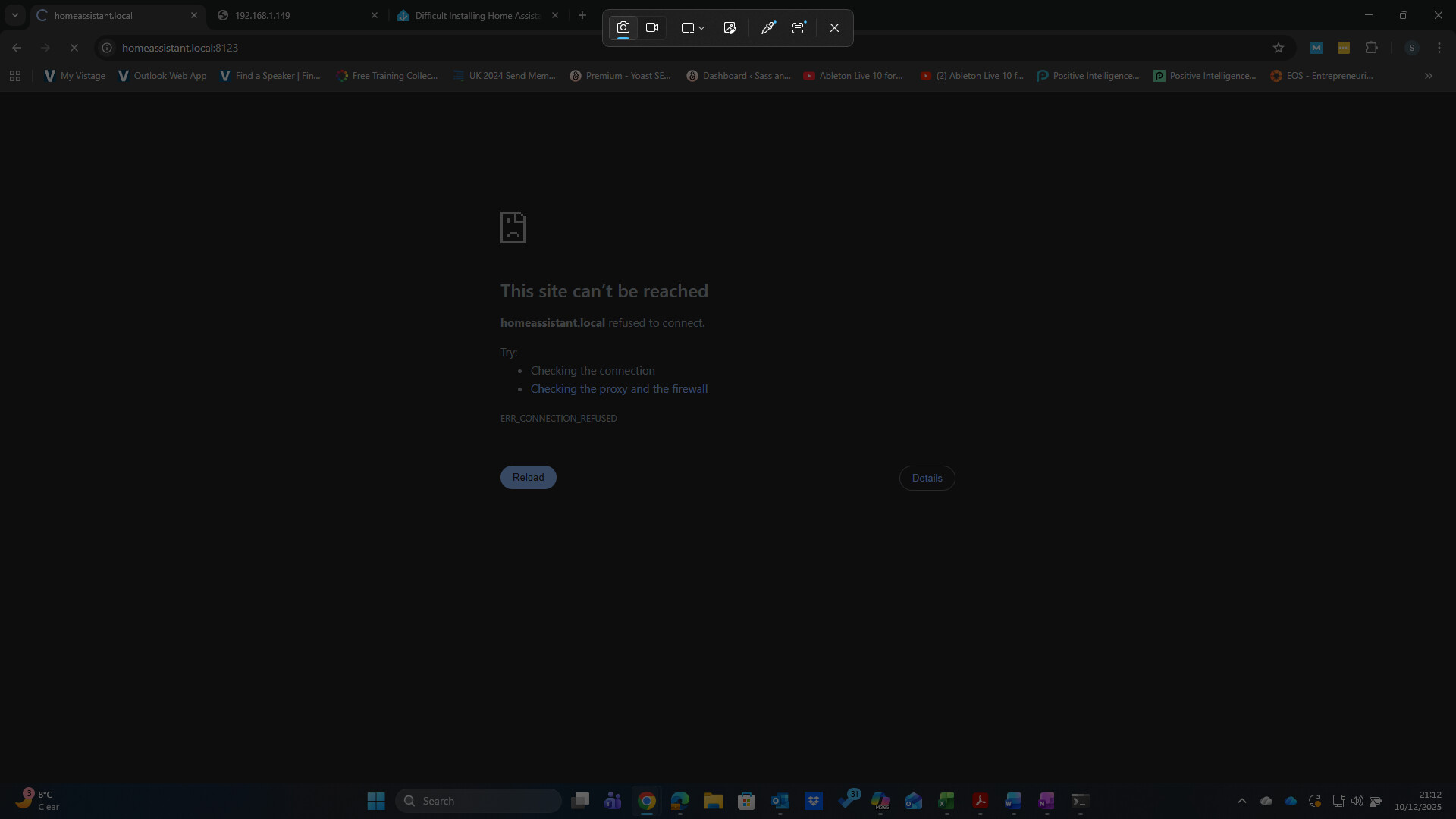

  3. I get the attached screen
Are you sure that this is the right IP address for your Green?

Try another browser, make sure it does not force httpS.
Are you using any browser extension that might interfere?
Can you ping the IP address from your HA?

Tried via Firefox - no forced https and no add ons … no response
Pinged and shows no errors?
can you please share a screenshot from HDMI screen and from the pings
