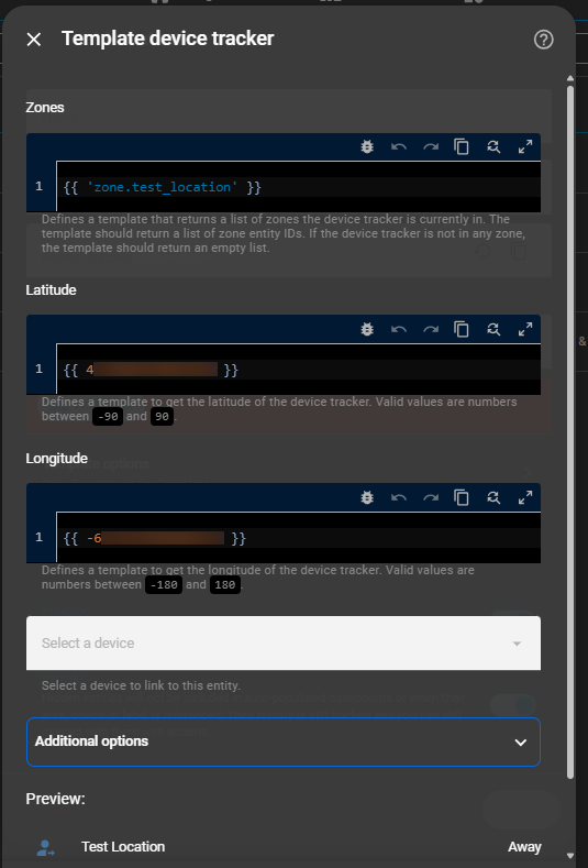

I’m having some issues adding a template device tracker through the UI.
Here’s my config:
…and I get this error in the logs:
Logger: homeassistant.components.template.validators
Source: components/template/validators.py:39
Integration: Template (documentation, issues)
First occurred: 11:46:43 AM (24 occurrences)
Last logged: 3:56:14 PM
Received invalid in_zones: zone.test_location for entity Test Location, expected a list of zone entity_ids
Received invalid device_tracker in_zones: zone.test_location for entity device_tracker.test_location, expected a list of zone entity_ids
Received invalid in_zones: ztest_location for entity Test Location, expected a list of zone entity_ids
Received invalid in_zones: test_location for entity Test Location, expected a list of zone entity_ids
Received invalid in_zones: for entity Test Location, expected a list of zone entity_ids
The entity zone.test_location is valid, and is quite large with the exact latitude and longitude expressed in the template config.
Any ideas what I’ve done incorrectly? I have another template device tracker for my home location, and it doesn’t throw any errors.
Your “Zones” template doesn’t return a list… like the error says.
{{ ['zone.test_location'] }}
Ahh, OK. I need an array. Thanks!
