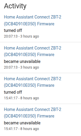

Also im seeing this activity in the ZBT-2 that looks odd
I had not noticed that until you pointed it out, but my ZBT-2 activity showing the same thing appears to align with my rebooting HA.
Not sure what to say about your other devices. :frowning:
