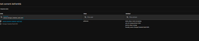

Difficulty configuring templates
The following sensors are unknown:
sensor.energia_slipper_rack_kwh
sensor.energia_presa_rack_kwh.
I’m attaching the .yaml configuration file to help you understand where I’m going wrong.

il sensor sconosciuti:
sensor.energia_ciabatta_rack_kwh
grazie
I am not getting these lines, are these comments?
Check if you have errors in log. Lines which I mentioned above are misplaced.
  1. According to the documentation for the Utility Meter integration, it should be utility_meter: and not UTILITY METER: like you have in your configuration file.
  2. The Recorder integration’s documentation indicates it should be recorder: and not RECORDER: and it should be entered without any indentation.
  3. I don’t know what you were trying to achieve with this but you should remove it.
You cannot comment like that in Jinja templates. This is especially true in HA when configuring a sensor in a way that requires a numeric output i.e. one with unit_of_measurement or state_class defined.
This will definitely cause a sensor to have an unknown state.
