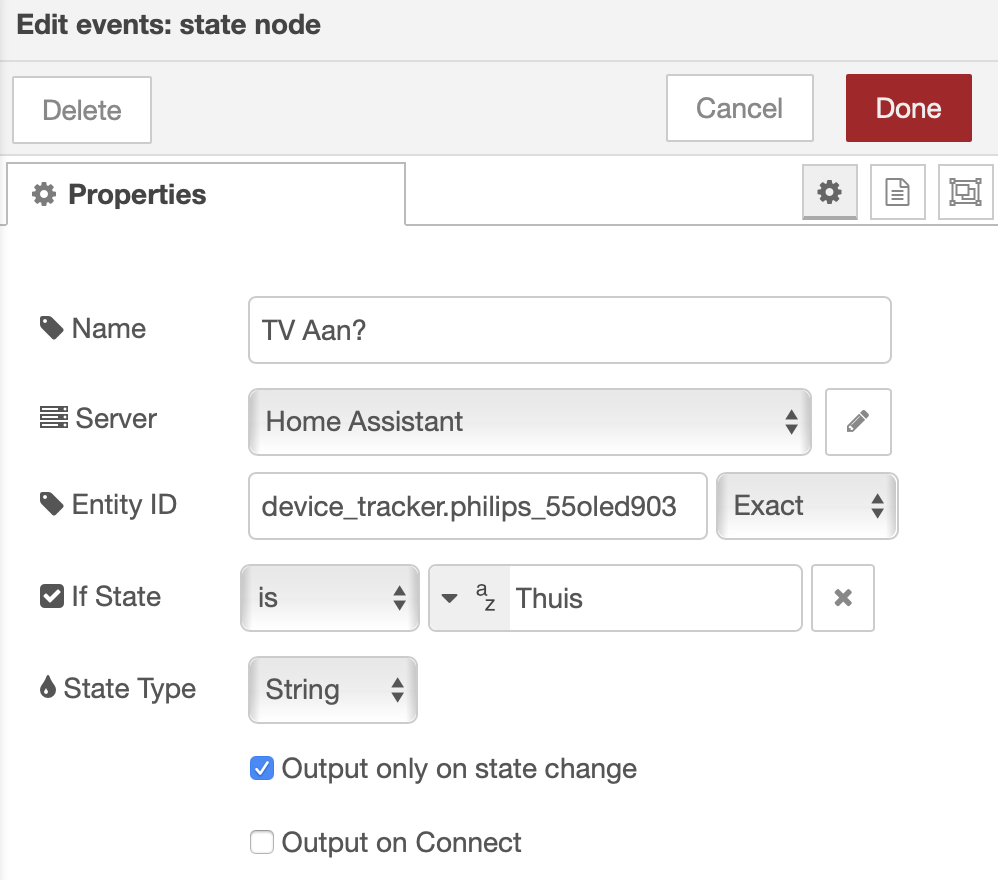

Hi, I have changed the Ping node to a Events State node, which is checking if the Unifi device tracker for the television is “Thuis” or “Afwezig”. When the state of this entity is “Thuis”, it means that the television has an active network connection.
However, the flow is not working anymore. Do you know what needs to be adapted? Do I need to add a switch?

Does the device tracker return “thuis” or “home”? (I’ve not dealt with HA and other languages).
I have checked the status of the Entity and have seen that the state is “home” instead of “thuis”. The entity shows “Thuis” in Lovelace, but “home” in the Entity section of Developer tools. I have changed the Events state node and now it is working! Thanks!
Hi greengolfer, thanks for your input. Based on the Unifi device tracker, the Ping node is not required anymore and the flow will not start every 20 seconds anymore.
