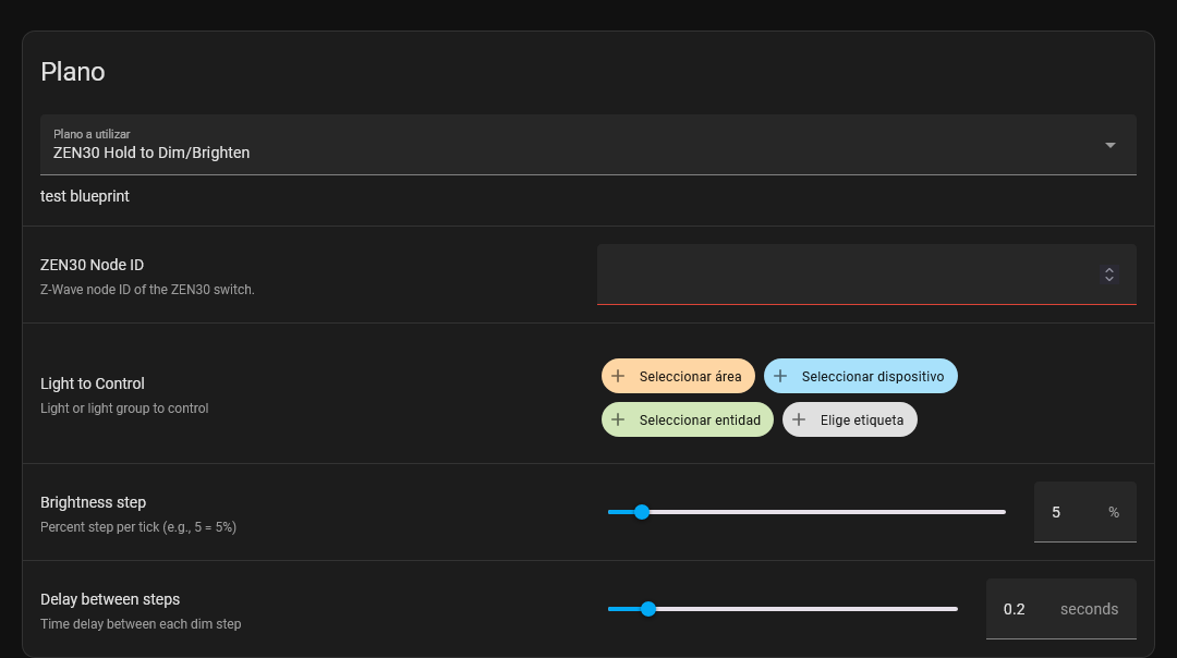

you know what i this will be easier to make a blueprint
blueprint:
  name:  ZEN30 Hold to Dim/Brighten
  description: test blueprint
  domain: automation
  input:
    node_id:
      name: ZEN30 Node ID
      description: Z-Wave node ID of the ZEN30 switch.
      selector:
        number:
          min: 1
          max: 255
          mode: box
    target_light:
      name: Light to Control
      description: Light or light group to control
      selector:
          entity:
            domain: light
    brightness_step:
      description: Percent step per tick (e.g., 5 = 5%)
      default: 5
      selector:
        number:
          min: 1
          max: 50
          unit_of_measurement: '%'
          mode: slider
    step_delay:
      name: Delay between steps
      description: Time delay between each dim step
      default: 0.2
      selector:
        number:
          min: 0.1
          max: 1
          step: 0.05
          unit_of_measurement: seconds
          mode: slider
mode: restart
trigger:
  - platform: event
    event_type: zwave_js_event
    event_data:
      label: KeyHeld
  - platform: event
    event_data:
      label: KeyReleased
condition:
  - condition: template
    value_template: "{{ trigger.event.data.node_id == node_id }}"
variables:
  node_id: !input node_id
  light_target: !input target_light
  step: !input brightness_step
  delay_between: !input step_delay
  is_dimming: "{{ trigger.event.data.scene == 2 }}"
action:
  - choose:
      - conditions:
          - condition: trigger
        sequence:
          - repeat:
              until:
                  value_template: "{{ wait.trigger.event.data.label == 'KeyReleased' and wait.trigger.event.data.node_id == node_id and wait.trigger.event.data.scene == trigger.event.data.scene }}"
              sequence:
                - service: light.turn_on
                  target: "{{ light_target }}"
                    brightness_step_pct: "{{ -step if is_dimming else step }}"
                    transition: 0.2
                - delay: "{{ delay_between }}"
                - wait_for_trigger:
                    - platform: event
                      event_data:
                        label: KeyReleased
                        node_id: "{{ node_id }}"
                        scene: "{{ trigger.event.data.scene }}"
save it to your \config\blueprints\automation
create a folder with you name and add a new file like zen30.yaml and paste the code
hope this will help you

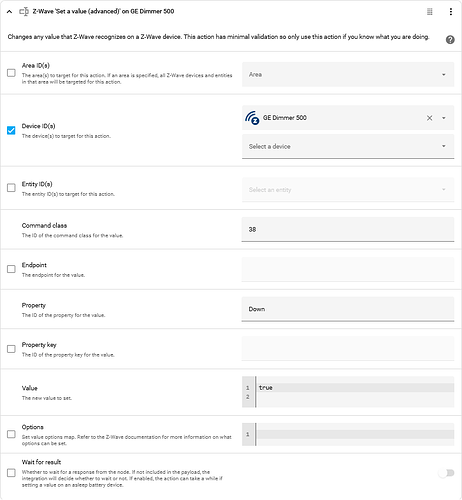

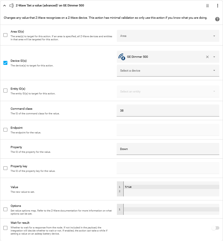

What you want to do is called performing a level change. It allows you to emulate the press and hold functionality of a physical switch using z-wave commands.
If you have z-wave js ui you can test this out by expanding the multilevel switch section and clicking the start and stop button. For example if you click the start button under perform a level change the device will increase its brightness until it reaches the max value or you tell it stop by clicking the stop button.
Perform a Level Change
To perform this action using an automation you need to use the Z-Wave: Set a value (advanced) action. It will ask you for a bunch of information which you can find in Z-Wave JS UI or by downloading the device diagnostic
21 = the node id of the device you are currently viewing
38 = the command class id
0 = the endpoint
Down = the property
In the value field you will need to enter true for start and false for stop.
Here is what the automation should look like

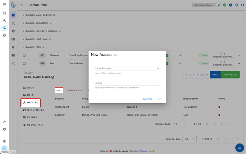

A follow-up to this thread. I tried both solutions suggested above, but I could not get either to work. That’s probably more a reflection on me than on the suggestions themselves, as I’m still new to the world of Home Assistant, YAML, etc. I subsequently had a few exchanges with the support team at Zooz, and they directed me down a path that did enable me to achieve my goals.
Their suggestion was to create an association group using Z-Wave JS UI connecting the paddle switch on the wall to the smart plug whose attached lamps I wanted to dim up/down from the paddle switch. The association group bypasses the Home Assistant hub and essentially creates a direct connection between the initiating node and the target node. Thus, the on/off and dimming commands from the paddle switch are sent directly to the smart dimmer plug, and I didn’t have to script anything special to make it happen in exactly the way I was expecting it to.
Here are the steps:
  1. In the Z-Wave JS UI control panel, select on the dimmer switch you want to use to control the lights. In the image below, the controlling switch is the Zooz Double Switch in the Office.
  2. Click Groups in the left margin
  3. Click Add above the list of groups associated with the device.
Then, use the drop-down options to populate the form.

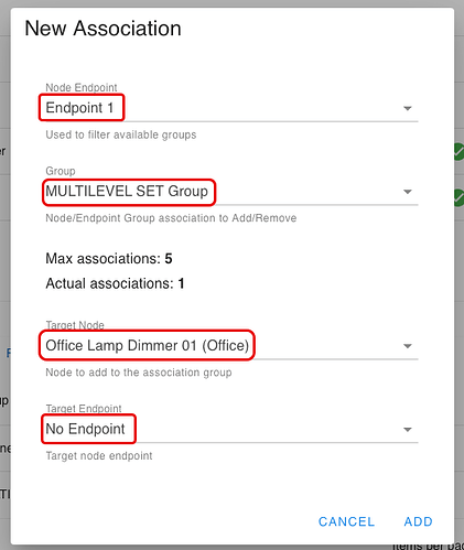

  1. In my situation, I was using a Zooz Zen30 double-switch to control the lights, so I had to specify Endpoint 1 as my controlling node endpoint. Where I’ve used single switches elsewhere in the house (using Zen77 dimmer switches) I’ve just specified the Root Endpoint.
  2. Select MULTILEVEL SET Group as the command group.
  3. Select the target node you want to control from the dimmer. In my case it was Minoston Smart Dimmer named Office Lamp Dimmer 01.
  4. Leave the target endpoint set to No Endpoint.
I don’t know why I don’t need to specify the target endpoint of the target node, but if I specify Root Endpoint (the other option in this case) the dimming doesn’t work properly.
That did the trick. Now the lights go on/off dim up/down just as I wanted them to.
