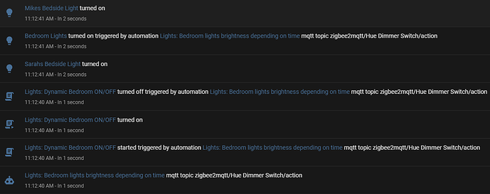

Below are the logs reported in HA, again I don’t see anything mentioning Dining Room lights.
When searching, I found a response in a somewhat similar thread here but the situation is slightly different as that person actually sees the light on action in the logs, where I don’t.
