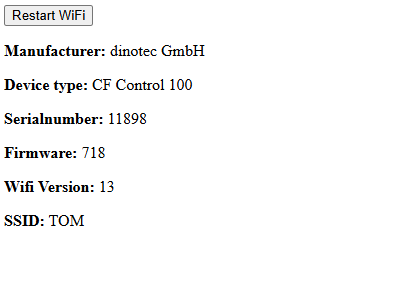

Does this also work for the CF100?
CF Control
I only have an app on my phone I can use, and there is an internal IP address i can go to, which gives me very basic info
I tried to query the CF100, but I didn't manage to do it.

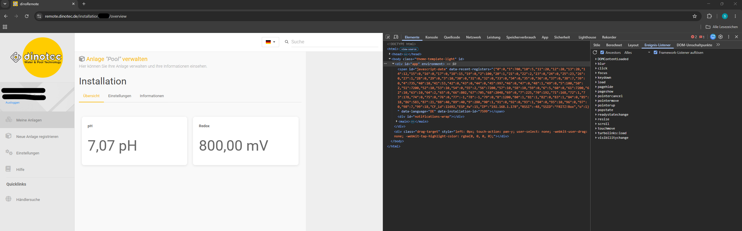

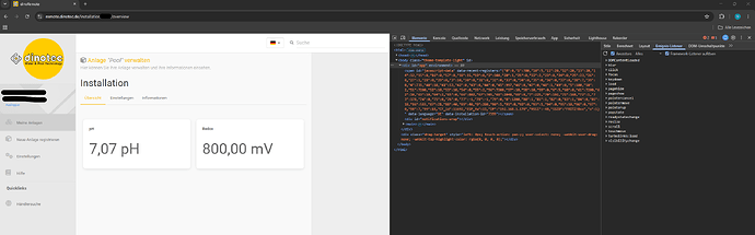

How do I get my client_id = "onhEPSHfqJ7kWswy" # Replace if dynamic?
@casaro , i hope you can help us to integrate the CF100 in HA :slight_smile: @tomspeijer
Via the page https://remote.dinotec.de I can query my system with my username and password. Where do I have to enter this data in the code? I also get a token displayed in the app.
in the webbrowser , i don`t need a token, only the login

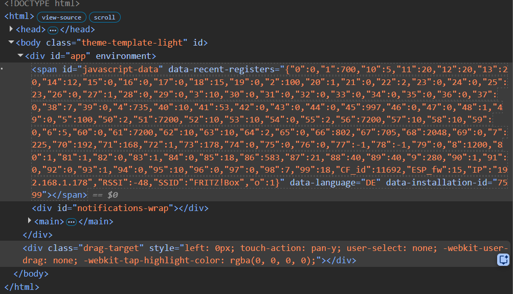

I got it to work.
For the CF100
There was a major refactor of the code on the DinoTec side. My current implementation (which works fine) looks like this:

        # Extract the JSON payload hidden in the HTML data attribute
        data_match = re.search(r'data-recent-registers=[\'"](.*?)[\'"]', res.text, re.S)
        if data_match:
            raw_json = html.unescape(data_match.group(1))
            data = json.loads(raw_json)
