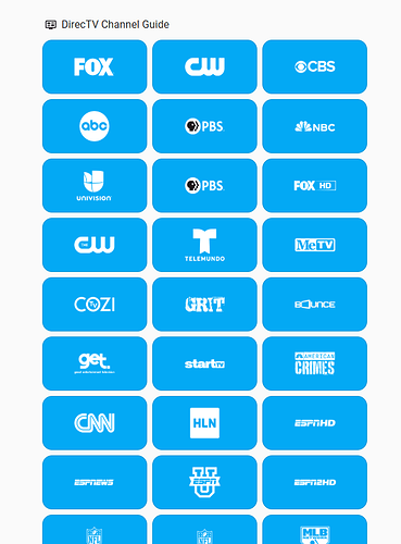

I have those in a “static” sensor. I created that from an XML (original JSON taken from DirecTV website):

Happy to send anyone the data for this, Putting it together, I created a custom PAD to select any TV station:
Updated as I found the URL set for colo logos, put it into a scrollable and fiterable container:
