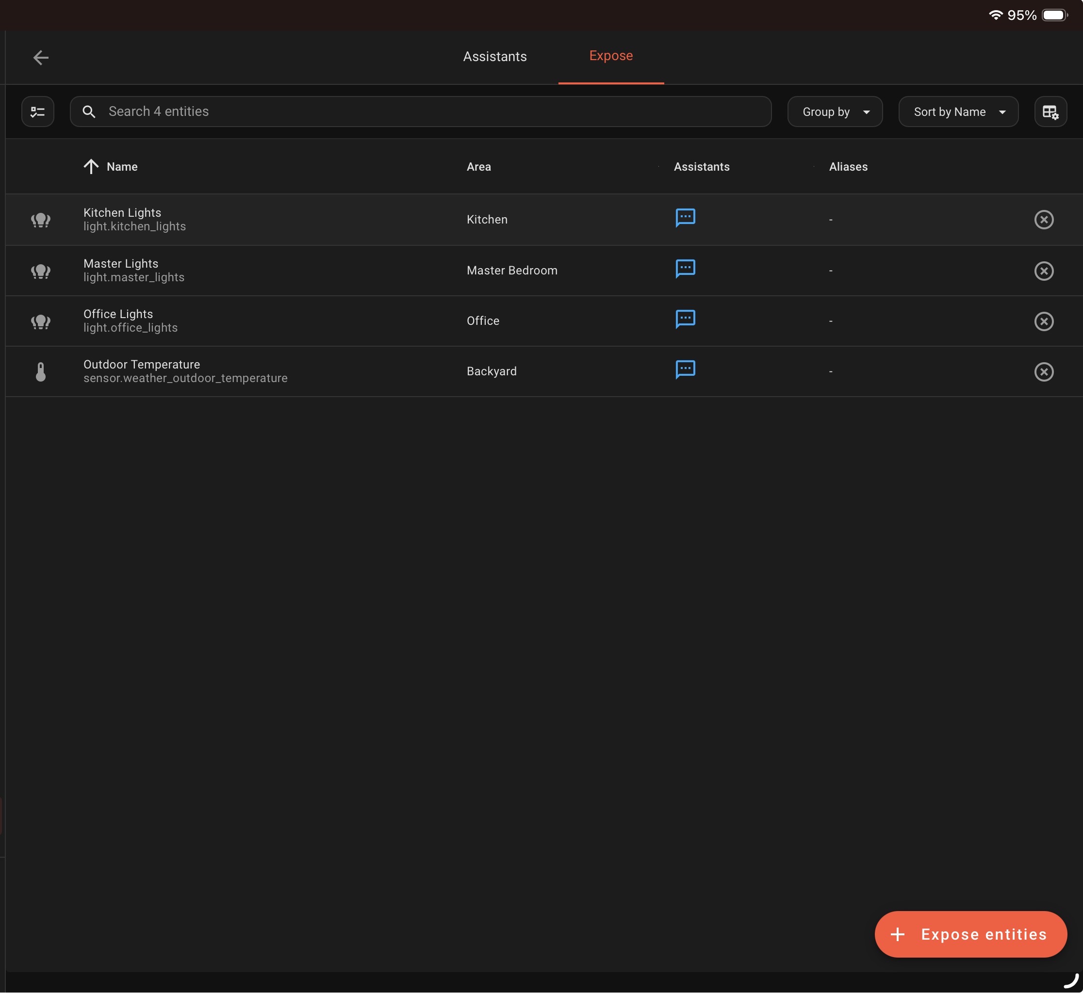

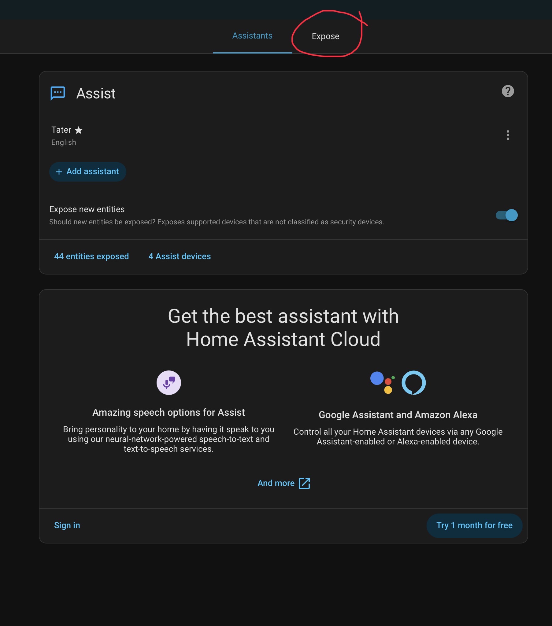

Here is where you can add or remove what devices the llm can see/use… the less you have here the better your tool calling will work
Keep it as simple as the things you will actually use with voice
And in your case remove the lights you don’t want to accidentally get triggered
The underlying problem isn’t that I don’t want the bedroom lights to turn on, the underlying problem is that I don’t want every light to be mistakenly turned on.
If you’re in the bedroom, or if you see the bedroom lights are on from down the hallway, I would want to be able to control them from another room. Disabling the expose would prevent it from being mistakenly turned on, but also prevent it from intentionally being turned on.
